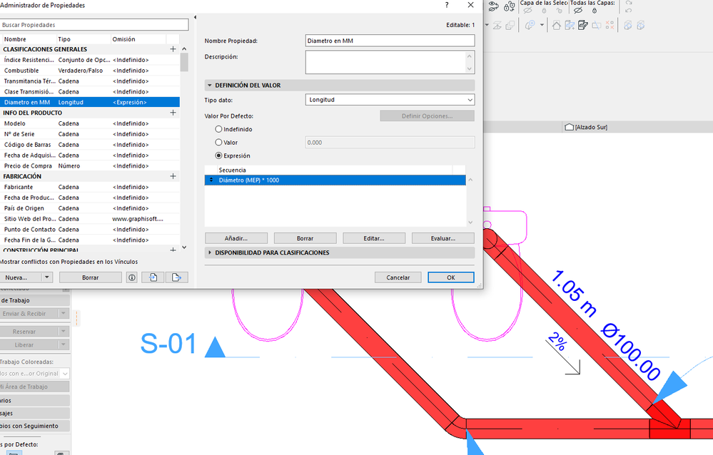

how can i create a label for pipe diameter in mm without decimals?

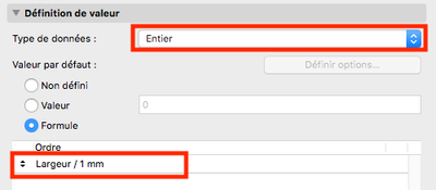

Yves
Like this
Yves Houssier
Belgium
Archicad 19 -> 24
iMac - Mac Os 10,13
Go to post

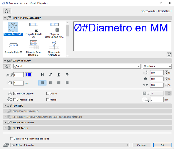

What are the settings you are using on the label?
 There would be an expression you could use to remove the decimals. But I think it’s probably better to adjust the settings of the label to not show the decimals.

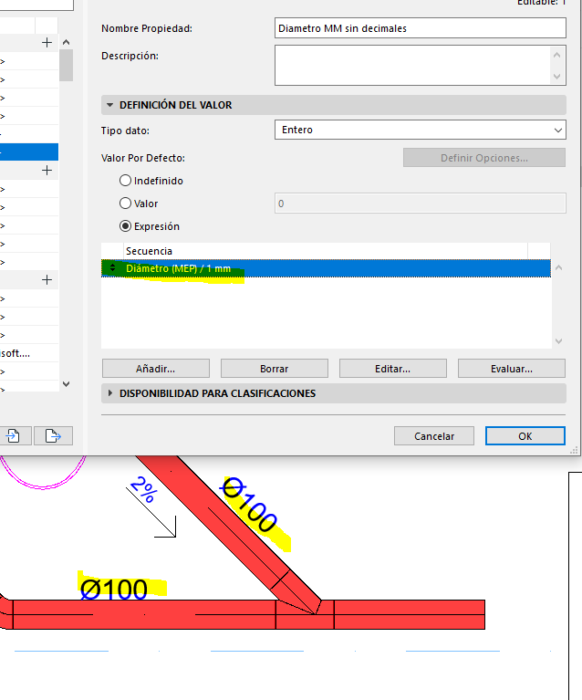

Guillermo1
its an autotext label
Guillermo1
i dont understand the solution but it works
