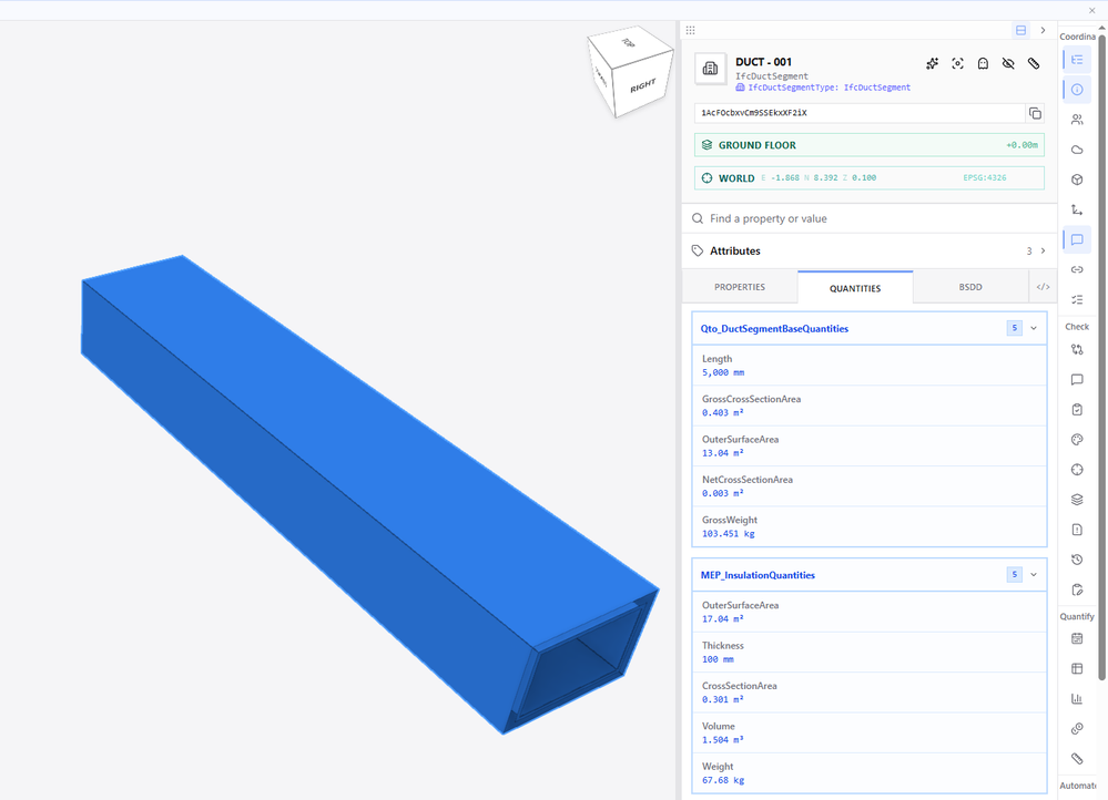

I looked into this with my buddy Claude (AI), to see what's going on with this situation, if there's anything we can do about it. In short: Archicad 29 (tested on 29.2.1, same in 30) does not seem to export IFC base quantities for MEP elements. With "IFC Base Quantities" on and using IFC4 export, walls, doors and windows get their Qto_...BaseQuantities sets in the exported IFC file, but IfcDuctSegment and IfcPipeSegment (the ones I tested) get none.
I found a few limitations on the Archicad side:
- MEP cross-section data (size, wall thickness) are GDL array parameters, which the IFC Property Mapping cannot map to IFC properties.
- Ducts and pipes are exported as zero-thickness shells (the outer face of the sheet/tube) plus a second shell for the insulation, so wall thickness and material are not in the file.
Workaround: post-process the IFC with Python (IfcOpenShell). I tested this on straight ducts, pipes and bends, and it gave me correct results:
- Length = distance between the two connection ports (IfcDistributionPort), as IFC4 defines it.
- Gross cross-section and outer surface area from the exported shell; insulation thickness and volume from the difference between the two shells.
- Net cross-section and weight need wall thickness and material: define them as Archicad properties per MEP type and map them to an IFC property, or use defaults (e.g. EN 1057 wall thickness by outside diameter for copper pipes).
- Write the standard sets (Qto_DuctSegmentBaseQuantities, Qto_PipeSegmentBaseQuantities, etc.) into a new IFC file, using the official IFC4 templates.
Note: for pipes, IFC4 GrossWeight is the empty pipe and NetWeight includes the contained fluid.
Here is a test result for a single straight rectangular Duct Segment (I modified the default insulation thickness of 30mm to 100 mm), viewed in the IFCLite Viewer. Claude AI helped me with testing everything and generating the Python script.
PS.: The summary was written by Claude.
