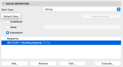

J_Tucks
Just by adding the rules as a sequence I assume?Screen Shot 2022-09-30 at 10.30.19 pm.png
