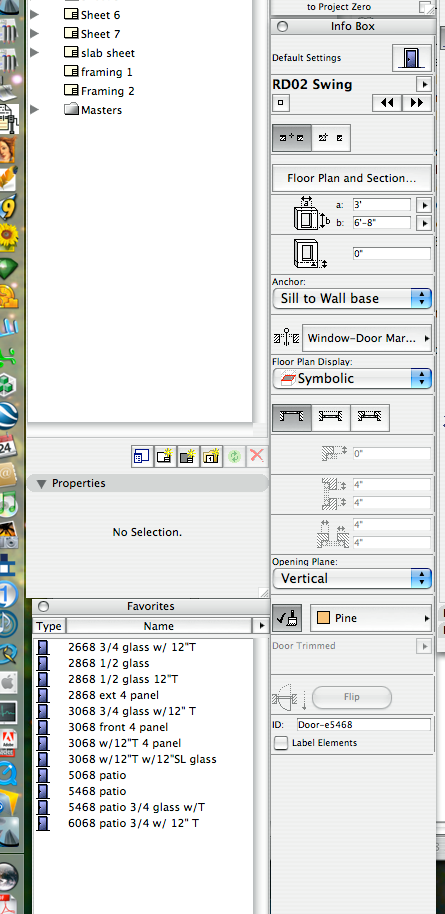

One of my favorite additions to ac10 is the tweaking to the favorite menu. Now your list of favorites is narrowed down to the active tool, so the list can be managed better. I now keep favorites located in a prominent spot next to the tool bar. It's very easy and convenient to select the tool and select a wall type, window, part.. etc.
