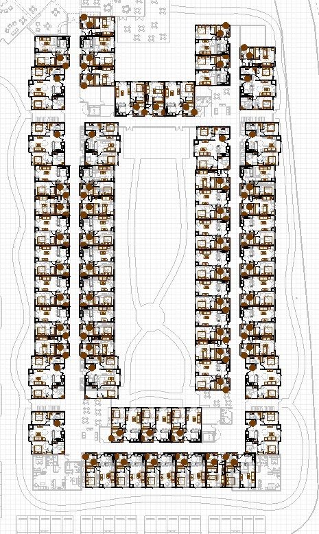

Some what new to Archicad but picking it up. Would like to see black and white display of elements but getting a few colors showing up. This is a floor plan created using hotlink modules of the units. Would like to see black entirely.

You need to adjust your PENS. Check what PEN # you are using and change them to BLACK. Assign that "pen set" to the VIEW that you place on your SHEET.
OPTIONS > ELEMENT ATTRIBUTES > PENS AND COLOURS
It's common practice to have number of pen sets.
At minimum have one that you work with within ArchiCAD ... I like to know that RED is 0.18mm thick, BLUE 0.25mm, GREEN 0.50mm etc ... it's easier to tell them apart than if everything is black and white.
Then you have a second PEN SET for you PDF publishing, with just blacks and greys etc.
Hope this makes sense.

jeffreyarch wrote:
/.........Would like to see black entirely.
You could also leave your pens as is and choose as shown in attached pic
