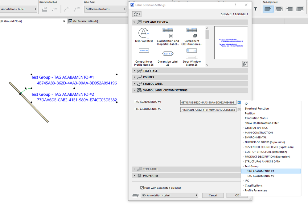

To find the property GUID, I usually use the 'property label 26' in an object, select which property I want, and save it as a custom label. So, when I open its GDL 2D code, I can find the selected property GUID to use in other objects that I'm creating. However, in this frustrating project (which predates my template in the office), when I save the custom label, it doesn't show any GUID. Does anyone know why or another way to find a property GUID?
Just to illustrate what i'm saying:
this is when it works, and the following images are when it doesnt work...
whyyyyyy

Not sure why your way is not working, but I've attached you a label object which can give you the property GUID in a different way.
Just use it to label some element which has access to the properties, similar to my screenshot:
To make the object yourself, you can paste the following code into the 2D script of new label object.

Actually wasn't happy that the GUIDs can't be easily copied so I updated the object to be able to select the properties in the label settings and you can easily copy the GUIDs from there. The new object is attached to this post.
Code
Need 2 parameters named myProperty1 and myProperty2.

WOW, that's awesome Bernd! thank you so much!
This is really waaaaaaaay easier, i can't express my gratitute enough!
