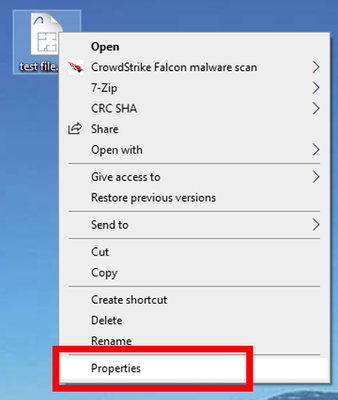

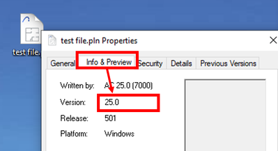

This happens when the file is created in a newer version of archicad
if you go to the file, right click and  properties, info & preview, what version is it?
if its version 24 or greater then you can not open it with Archcad 23.
Archicad will open files created in older versions software, but will not open files created in newer versions of the software.
if the old file is more than about 8 versions behind the current version, check the reference manual to see if the current version will open it.
I hope this helps.

Archicad 23 is an old version - current version is 27.
You are probably trying to open a file created in a version newer than 23 - so 23 can't open it.

Hi, yes apparently i just saw a post regarding my problem. Now I'm trying to download Archicad 27 to see whether I can open the file. Thank you for replying though.
I'm so stupid, it seems I didn't check which version the template was made and assumed right away that it can be open in Archicad 23. Thank you for solving my problem. I'm now trying to download Archicad 27 to see if my problem is solved.
