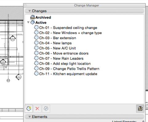

Change Manager- Removing Duplicate Changes
Ideas on how to fix this. thanks

Does this clip help?:
http://www.youtube.com/watch?v=EX7985i4iK0
I am a bit confused about how come you have Ch-03 so many times in the list. Do you save part of your project file as a module and then place it back as a hotlinked module?
Eduardo Rolon
Good idea but I had removed all modules from that file and on a restart/reopen they are gone. Hmm
