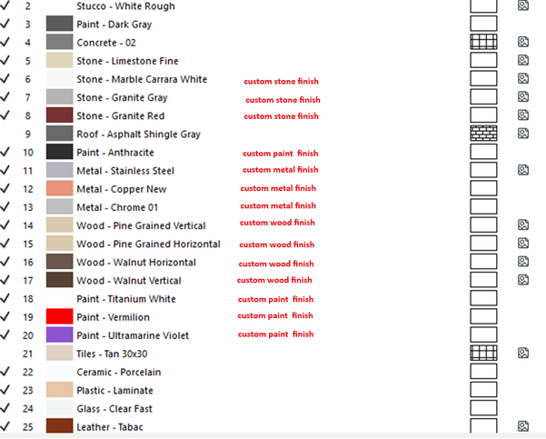

I screenshot the comment I'm speaking about.
I ran into this problem. We are using 27 solo and I want to go up to 28 solo soonish. I edited a ton of things in our template.  It works fine, but now that I started working on a 28 template I'm learning a lot of default objects have missing things. I didn't notice before because I have favorite starters for almost everything we use daily.
I can't fix 1000s of objects. I'd be better off almost starting fresh and then redoing all the changes to surface names and images. You mention fixing it with the index numbers. Can you get more into detail about this? How do I know what the default index number I'm missing is? There are two columns of numbers in the attibute manager? Which is the index number (one doesn't say anything, the other has a work street sign looking thing as a header)? I think this might be my best course to go from my 27 solo template into the new solo 28 global library. I'm trying to do some research to avoid doing things twice or more. I'm limited in some of my attribute management because we are using Solo version. That's why I manually changed surface names to names with numbers for our office.
