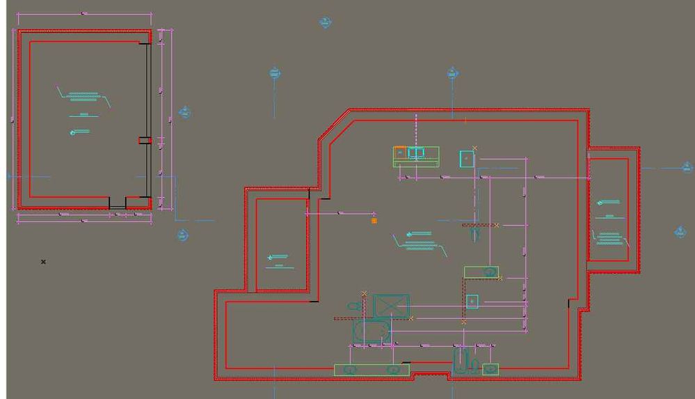

I have dimensions being delated by ArciCad. I'm using a complexed profile wall. Had the foundation fully dimensioned, went to the floor plan, came back and most of the dimensions associated with the walls where gone. BUT not all, the garage foundations walls are there. Checked all layers nothing. Yes the profile is the same on the garage walls and the home. Please see the screen shot of this plan. I have added the dimensions in 3 times now and they will not stay. Tryed different things like saving just as it get them done, auto dimension, etc...
Anyone have a clue?!!?!?

Don't change the cut plane. Your dimensions were catching those corners at the cut plane and when you moved the cut plane it disassociated them from the points.
Happened to me before. Drove me crazy.
