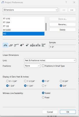

I dimension a plan
I go to Options
then Project Preferences
Then Dimensions Set as Feet and Fractional Inches
Then None for Fractions
then 1'-0"
Save and create by Name "M2"
Now I do into mile file to work and it will for a bit,
then I plot and find the fractions are back.  I have to do the same process and it works again for a bit but reverts back to fractions
I select the "M2"  and that works for a bit but then the file reverts back.

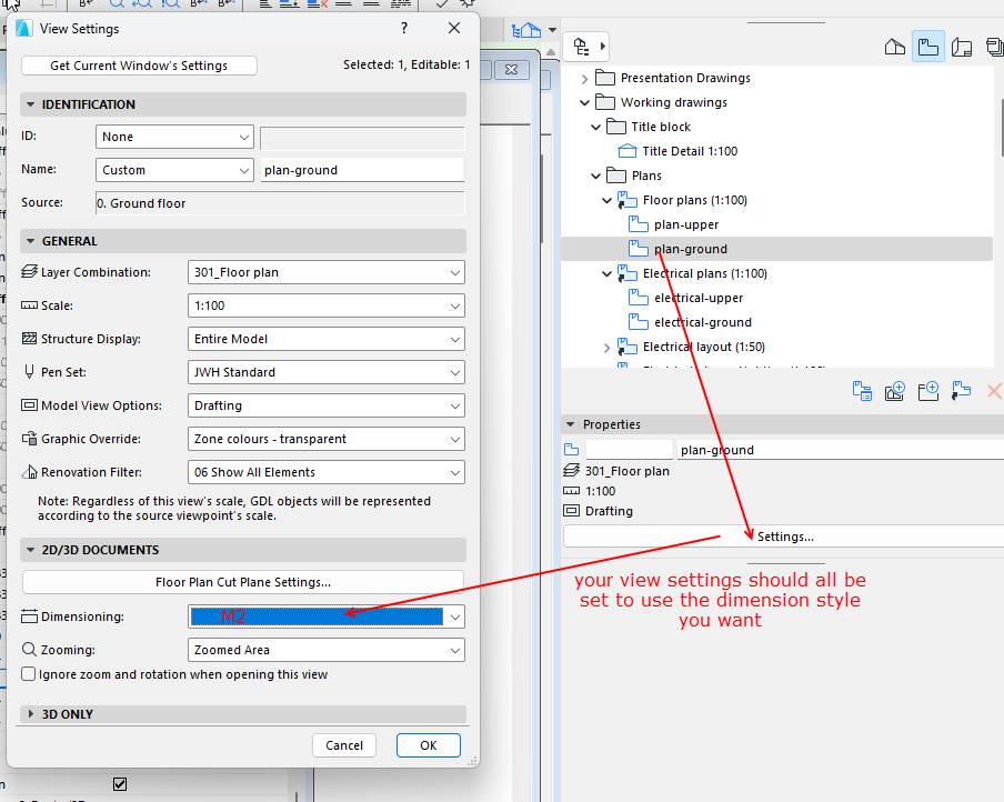

Dimension settings are part of Views.  All (most) work should be done in well-defined views... done once for a template, and you're set for all future (similar) projects.  It sounds like you're using View Points some times and Views others.. which will result in all settings being switched to those of the last View activated.

When you go into the dimension preference settings, "M2" is still set exactly as you want?
That is not changing there is it?
Have you set your views to use the "M2" dimension style?
Not just changing the style you are using on screen, but by actually changing it in the view settings.

This is the way it is supposed to work.
When you create a view, you should be setting all of these settings as to how you want the view to appear.
It is that view that you then place on the layouts as a drawing.
With the correct settings, you are guaranteed that your drawings on the layouts will display as you want them.
@Eric Milberger wrote:
It there a way to apply to all drawings.
My setting would apply to all plans and elevations, and Building Sections
How to you update a template?
You can select more than one view in the view map list at the same time,
Don't select the plain folders - they don't have settings (cloned folders with the black arrows are OK).
Then open the settings and change them all at once.
