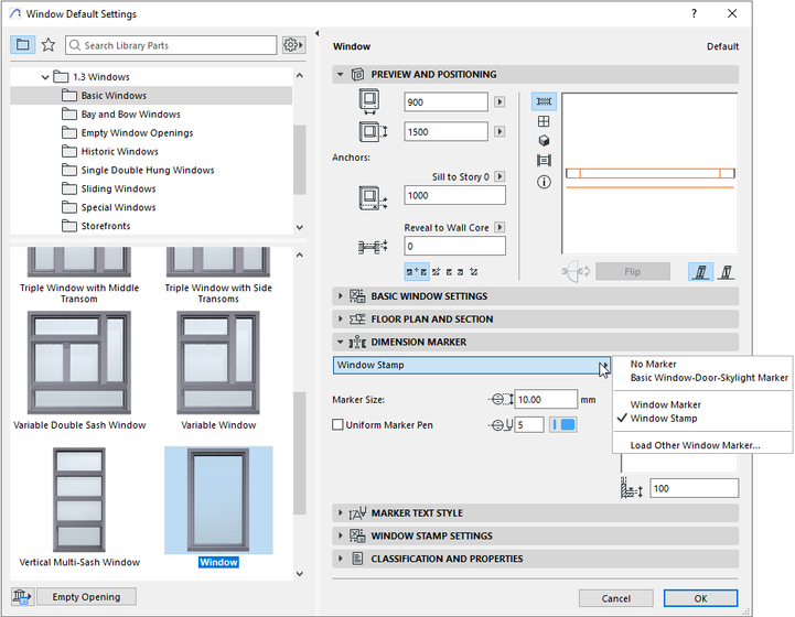

Maker text style and Maker custom settings is grayed in window settings in my ArchiCAD 28. How to re

Benluwizzy:
Which Marker is selected under Dimension Marker?

To expand on what David wrote:
Make sure that you have selected an option other than the "No Marker" option for the Dimension Marker.

Actually the option selected under "Dimension maker" is the "No maker" option
That is why those two panels are disabled. They are enabled only if you select a Dimension Market for which there is an interface defined in its GDL script. So, you need to choose another Dimension Marker.
