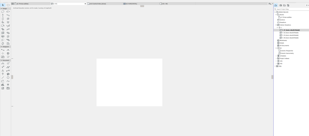

Interior elevation empty
Gabriele2
Hello everyone,
I have created a interior elevations of a room but it's empty. In the settings I can't find any place to change zooming or anything similar as I believe my model can be too big or small
3 REPLIES 3
jl_lt
Ace
Hi! i would check first what floors are shown by the section marks; Sometimes its set to cut one floor above and it shows blank.   You can find it in the section settings.
NateLumen
I would also suggest checking the horizontal range (how far the view can see) in the Interior Elevation Selection Settings.
I am also seeing that you are viewing the interior elevation from the Project Map (on the right), if you go to the next tab (View Map) you will have views with designated view settings (Layer Combinations, Model View Options, Graphic Overrides, etc.). These can all affect how your view shows up so I would check and make sure all of those are set correctly.
