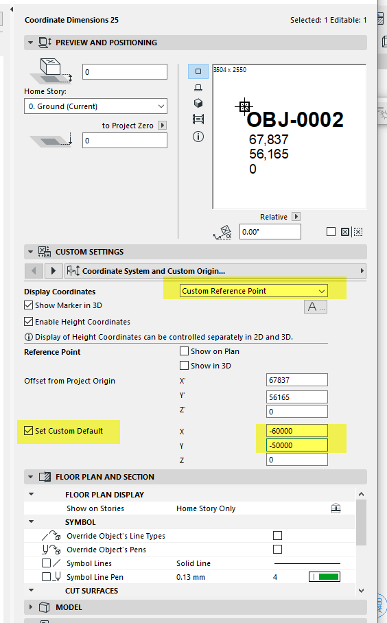

By default the measurements are taken from the Project origin.
I am assuming the brown text is not from Archicad?
But do not model far from the origin - Archicad will not like that.
You can set a custom origin in the object (negative values of your datum point) and it will dimension from there.
There is another one called 'Survey Coordinate Dimension' and that can calculate values based on the survey point location.
Sound like that may be what you want as you don't have to play around with negative custom origin.

2023-08-31 11:06 AM
Yeah. It was very basic. I did not change this object to "Survey point". Now I have what I need on the object. However, I did not manage to copy those values.
Instead, I at least understood that I could use measuring tool. Hovering over a point then tabing to coordinate values and ctrl+c. It works for now.
Project origin was correct.
