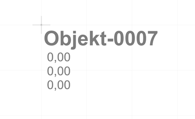

This is a recurring problem in our office at least since Archicad 15. Sometimes the global origin is no longer in 0,0 in some project files. I have tried to reset the user origin, restart Archicad and selected the "open and repair" option on start.
Everything looks as if the origin is in 0,0 in the plan view but when you drag parts into a gdl-script the coordinates are way off. Anyone who's got a solution to this? The picture is from a project in AC24

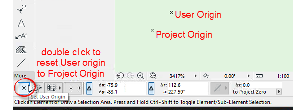

If by Global Origin you mean Project Origin, then that is always at 0,0.
It can't be moved.
You can however set a User Origin where ever you like.
They both appear as a little cross.
The Project Origin will be grey if you have set a User Origin position.
To reset the User Origin back to the Project Origin, double click the 'Set User Origin' button which you can find in the Coordinates Palette (which I think should always be turned on).
Then anything you model at the Project Origin such as a hotspot will script with 0,0 coordinates.

Thank's Barry for your answer but as I wrote I already tried to reset the user origin. That is not the problem. The problem is that although things are placed in 0,0 at the floor plan the coordinates in a gdl-script don't correspond.
If I copy elements from the corrupted file and paste into a new document (paste into original location) they land in 0,0 on the floor plan and get coordinates 0,0 in a gdl-script. As I wrote this is not the first time we have encountered this problem and I wanted to know If other people have experienced similar issues.

‎2023-08-28 04:15 PM
There is a script at page 432 in the GDL ref. guide (Ac24). With this script you can separate the "world origin" from the "virtual origin" and the "object placement". I don't know what a "virtual origin" is but in my file the world origin differs from the virtual origin. It seems as if the virtual origin is the real 0,0 since if Idrag a hotspot from this point into a gdl 2d-script it reads hotspot2 0,0.
If I place coordinate dimension objects as in Barrys example it shows this:
