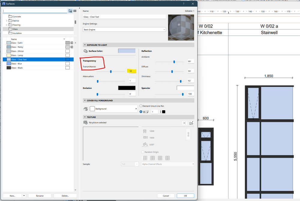

The only feasible solution to this is reducing the Surface Transmittance to a Value of 50 or less. Go to Options > Element Attributes > Surfaces. Look for Exposure to Light > Transparency > Transmittance. Reduce the Value to not more than 50. This ensures that the surface is translucent enough not to enable the projections in the Elevations and Schedules to see through the surfaces thus seeing only the relevant lines depending on the side the projection is facing.
