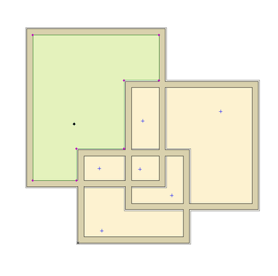

Oof. It happens in a brand new file with a default template. When I created a few zones, and I tried to edit them, it showed the same behaviour, although it was much faster since it's an almost empty file. But loss of focus when pressing enter remains and it's a process measurable in seconds, not tenths of a second as it should.
Floor plan:
