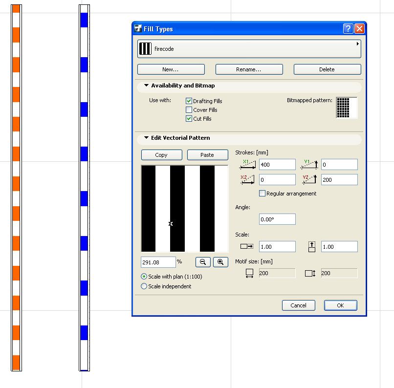

andyro wrote:
Link, fair enough (use colour, simple, easy), but that document set I referred to just cost the builder $14k (USD) to print - every set included the fire plans (I am always shocked and amazed at these printing costs). Colour was not an option. We have 4 linetypes for different ratings, and they print black - aka. inexpensively!). I would love to find a way to do this while preserving auto-updating.
But for the cost of printing..
(That does sound very high!)
Anyway, a different technique you may find appealing is using color and/or composite fills to show firecode walls. Attached is a pretty rough mock-up but you get the idea of how fills can be used in composite to show a dashed line.
You gotta admit - there's no missing them!

We have been using links method for creating the dashed lines. Rex was nice enough to show me how to do that when I met with him in Yosemite.
