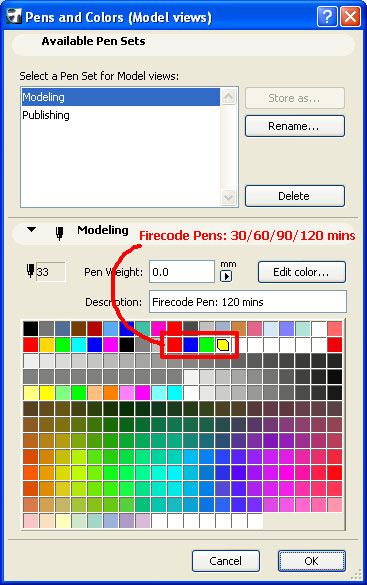

It would be easier if you could do without the dashed line and just use color. It's more common to just assign specific pens for fire codes, that in the fire code plans show as color for the entire wall, and in other plans are just mapped to regular cut fill colors. See the attached image that shows an example of specific firecode pens in a template.
If you still wanted dashed lines, you could use this same technique to hide your dashed lines in regular plans. As you said map it to white, along with the composite's cut fill pen. Automatic update is fine - and recommended of course.

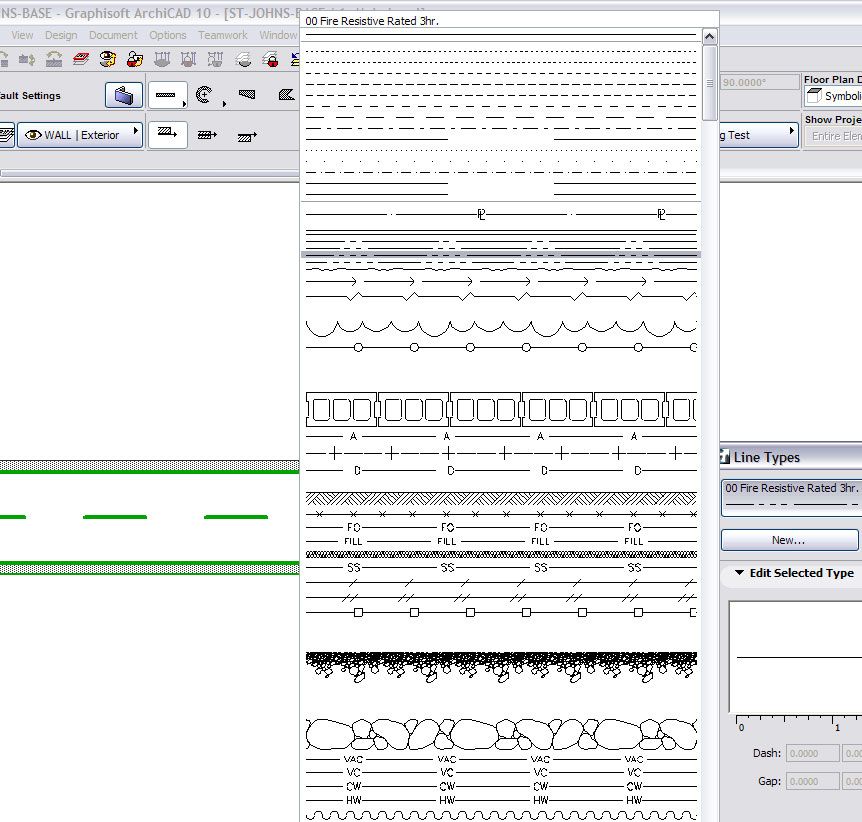

LiHigh
Wall accessories would be a good solution but NO curve wall.
I've an object(Wall accessories) which allow user to assign any line type drawn along the core axis and it's associated to wall. I don't have the object with me now; But if anyone is interested, I'll post it here later.
