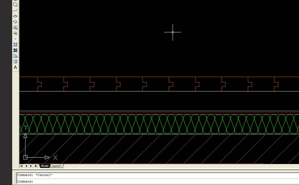

Fills in Archicad. How to do this?!
How can I have fills that are placed inside wall layers, are automaticly alinged with endlines, can create custom fills and apply them to any layer

But regardless, the short answer is that you can't have a scalable fill with an adjustable origin point in a composite structure.
Your options are to:
1) Use a different type of fill that doesn't depend on origins.
2) Draw it as an empty fill, and apply a 2D fill over the top later. I might mention that there are some LINETYPES that may work better for this than a fill (see the 3.5" batt linetype in the standard template file). Unfortunately, you can't use such a linetype in a composite structure, but they are very fast to add afterwards. The composite structure will give you snapping points, too.

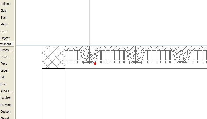

I created my own pattern that I applyed over an empty slab fill. The problem now is that I canot control the position of the fills pattern. Like, lets say that I would like that my pattern starts at red point.
Can this be done?
Thanx!

You can control were your fills start.
If you search in the help section under "Fill Origin" you can read all about it…
This answers your previous post. HTH
