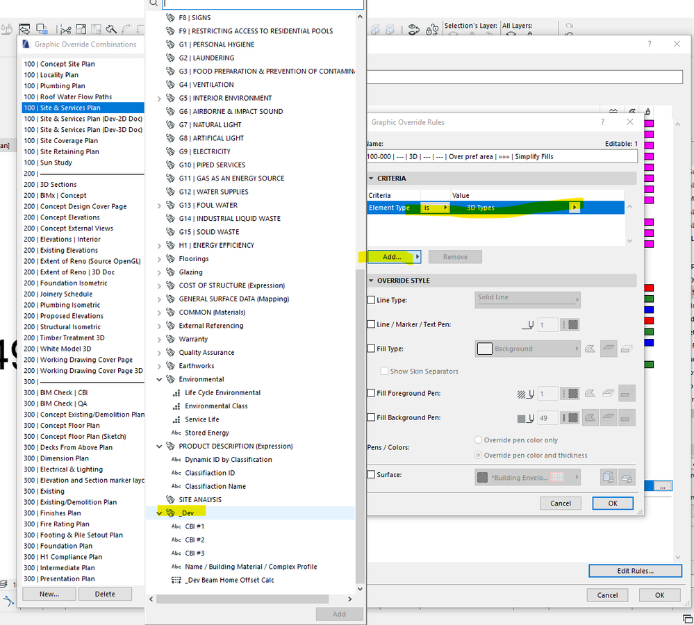

We are frequently getting feedback that recipients are having trouble open PDF plans due to the vectorial hatches.
One of the main culprits on our end is paved surfaces (driveways).
I have set up an expression [string] (IF ( {Property:General Parameters/Area} > 50 m2, "Yes", "No" )).
With the hope that I could graphic override those elements whose value read as "Yes", to simple background fill.
However, this property does not show in the available criteria of Graphic Overrides.
I also tried a variation as a True/False this also did not show.
Any idea why this is happening?

Certain parameters and properties are not available as Graphic Override criteria. Here is the reason why:
https://community.graphisoft.com/t5/Document-Visualize-forum/Expressions-Property-Value-type-dont-sh...

@Josh Verran Shot in the dark, could you simply assign a GO in your view settings relevant to the drawing scale. So if you have 1:50 drawings the GO changes all fills to "Background" pattern and at say 1:10 there is no GO assigned to the view?
Erwin Edel
Rockstar
With a 2 step progress to avoid this limitation, you can get this to work.
Have a 2nd property that you have to manually flag and use Find & Select criteria to find your first property.
You can save the find & select search to use it each time.
To make it a bit easier you could just convert the area to a number with STRTONUM ( STRCALCUNIT ( {Property:General Parameters/Area} ) ) and use find & select to determine if it larger than x amount.
