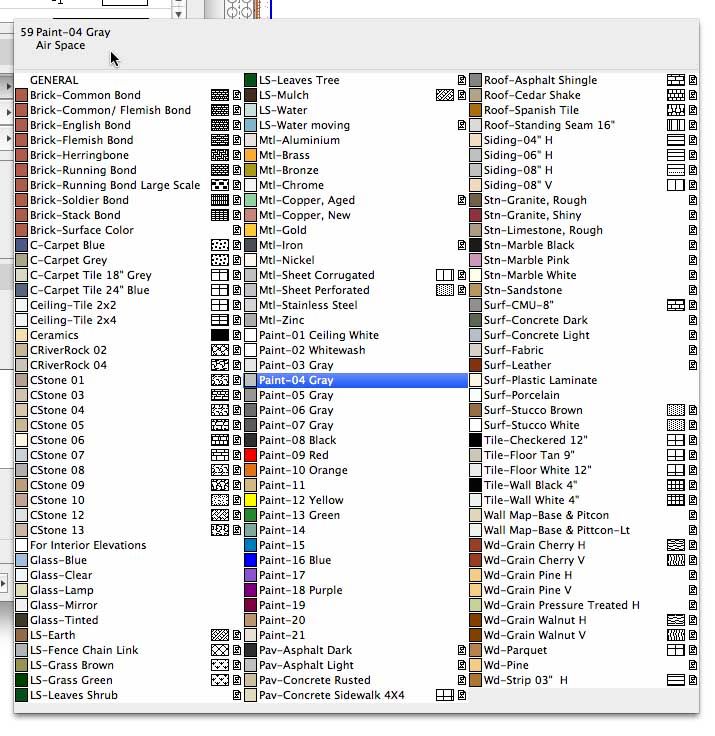

I want to add a folder of textures to Archicad's stock folder of textures, so that when I open the wall tool, for example, I can assign a different texture to the wall.
laszlonagy wrote:
because you do not want to import materials, you want textures to get automatically assigned to materials, if I understand it correctly.
See attachment. I want more of those.... can I do that by adding a folder of textures?
No, you will have to duplicate material, rename it, set material attributes, assign the desired textures, one by one, unfortunately.
Once you do this you will be able to transfer these materials from one project to another with Attribute Manager.
