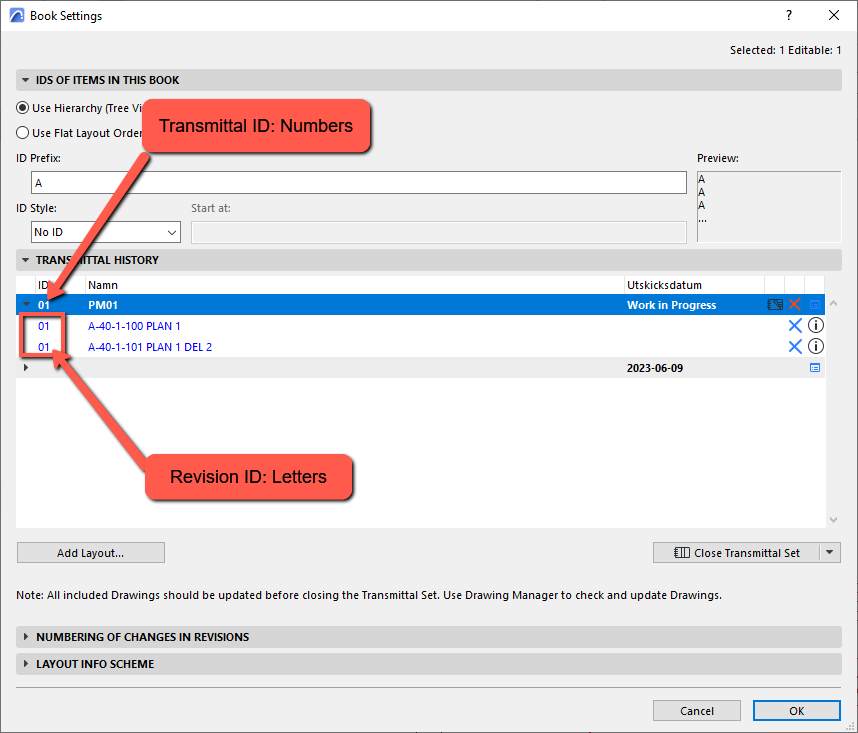

I'm trying to create an office standard where the revision IDs in the change manager process being in letters, A, B , C etc. (see image), and also it being smart where it recognise that it needs to start over the letter count for every layout that gets it's first change.
The problem I have right now is that the Revision ID follows the same numbering of the Transmittal ID, is there a way to break these apart so that the Revision ID has an automatic numbering of letters?

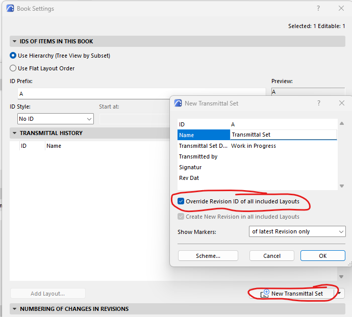

When you set up your TransmittalSet - tick the box that says "Override Revision ID of all included layouts"
I'm pretty sure that should do the trick.
You can take a look here as well: https://helpcenter.graphisoft.com/user-guide/128649/

Thats what I did in my screenshot, but doing that will only make the Transmittal ID and the Revision ID the same for me, as it looks in the image I uploaded.

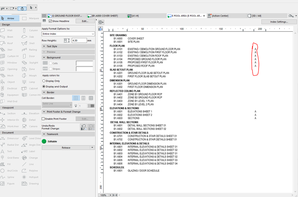

I can make the Transmittal ID with a Letter and then the Revision ID will follow along for the first transmittal. But when doing that, the next transmittal set gives a revision ID of 0 all of the sudden for the layouts that has it first change, see image 2.
So it's kind of 2 seperate issues here, first having the transmittal ID and the Revision ID have different count methods and second, why do I get a revision ID of a 0 all of the sudden for the next transmittals. Hope I'm making my self clear here.

I ended up going to the Drawing Index and changing the number to a letter. Not as comprehensive an explanation as other posts but it works! The transmittal automatically updates to the next letter. 😁🤘
