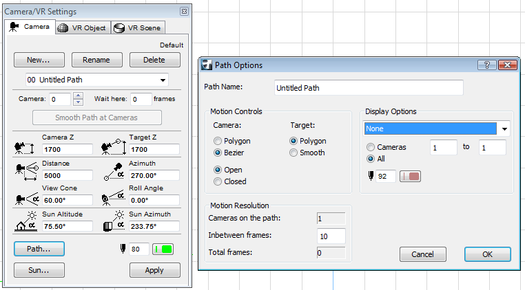

Or go to the Camera Settings Dialog, go to the Path subdialog and set the Display Options field to 'None'.
