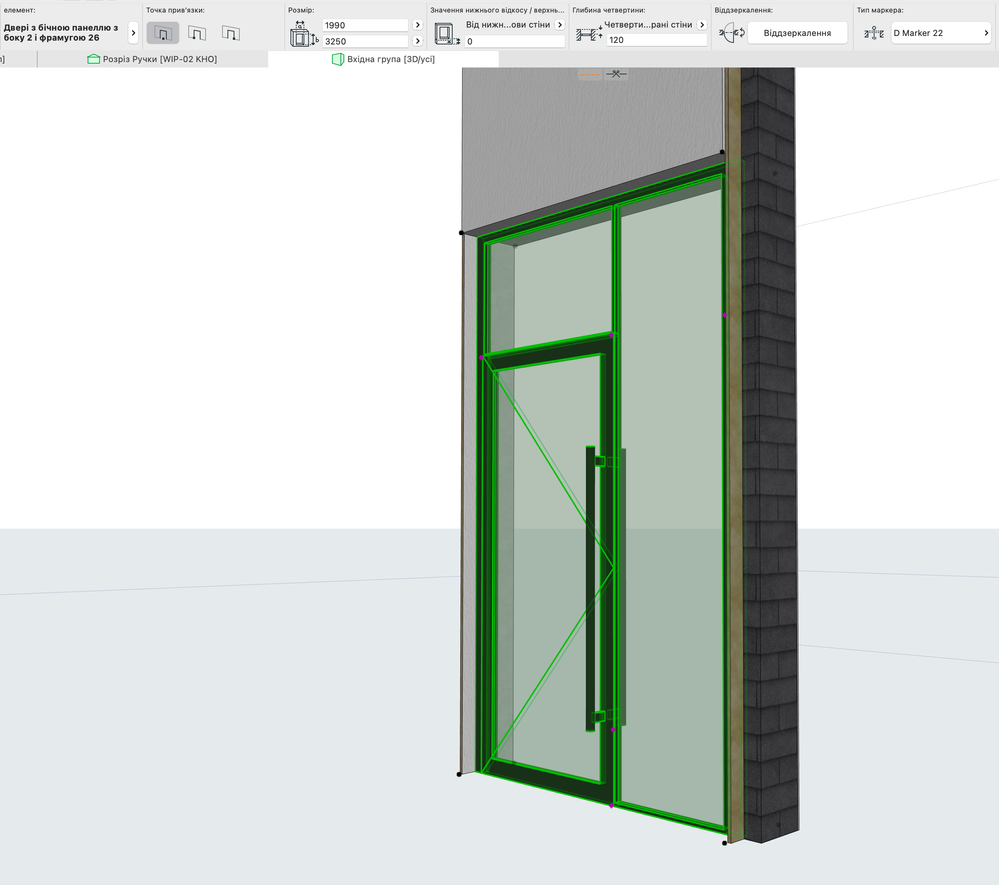

The Handles are Unique, and we need to specify them separately out of the Door. How can we get only Handles in our Schedule?

You can't schedule the handles directly unless they are separate objects.
Then you would just set up a schedule looking for those objects.
But as they are a part of the door, you will still have to use a door schedule that looks for the doors.
If you don't want to list the handles in the door schedule, you can duplicate the schedule and rename it appropriately (door handle schedule).
Then in the schedule scheme settings for the fields, you will delete all the fields for the door info that you don't want, and add fields that get the parameters for the handles (you can add library part parameter as fields - the little black arrow next to the Add Fields button).
You won't be able to get an image of just the handle though, unless they are placed as separate objects and not as part of the doors.

The second question on this site is — How to create Uniques Handles on each side of the Door? For example, if I need an Individual Handle on the Entrance door — a long cylinder ouside and a simple handle inside — I need to create these Objects and put them separately from the Parametric Door. And if changes come, and we all know — they will come 🙂 And this Door will be mirrored or moved, and a user who makes it (for example, in Teamwork) will not know about the separated handle — it will be a collision.
So, I propose to make these changes in Standard Doors in Archicad parametrical:
- separated kind of Handles of each leaf side
- scheduling the Handles separated from the parametrical Doors

However, if we get the unique Door, how can we get the Schedule of these Handles separately?
The same way as I mentioned in my previous reply.
If your handles are a part of the door object, you have to schedule the door parameters.
Only if you place the handles separately, can you schedule just the handle objects themselves.
If the standard door objects don't allow for different handles on each side, then unless you are conversant with GDL, I would not try to create or amend the door objects.
Just place the handles separately.
Unfortunately you can not group the handles to the doors so they move together.

I assume you want to schedule the 2D front view or 3D model of only the handle? Because it is easy enough to schedule which handle a door has by adding gs_handle_type parameter from the door object to your schedule. This field is text only though.
