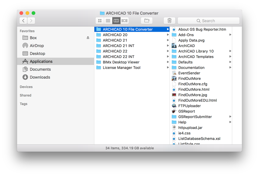

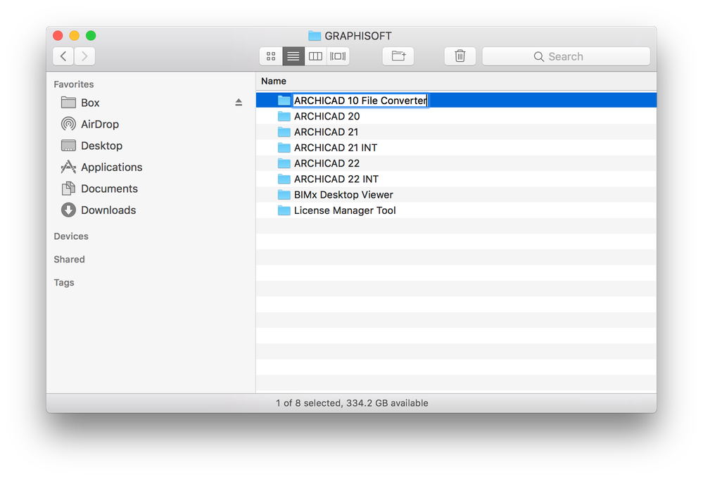

5. Go to /Applications/GRAPHISOFT and create a new folder entitled "ARCHICAD 10 File Converter."
6. Copy all of the files from the DMG or ZIP into the "ARCHICAD 10 File Converter" folder.

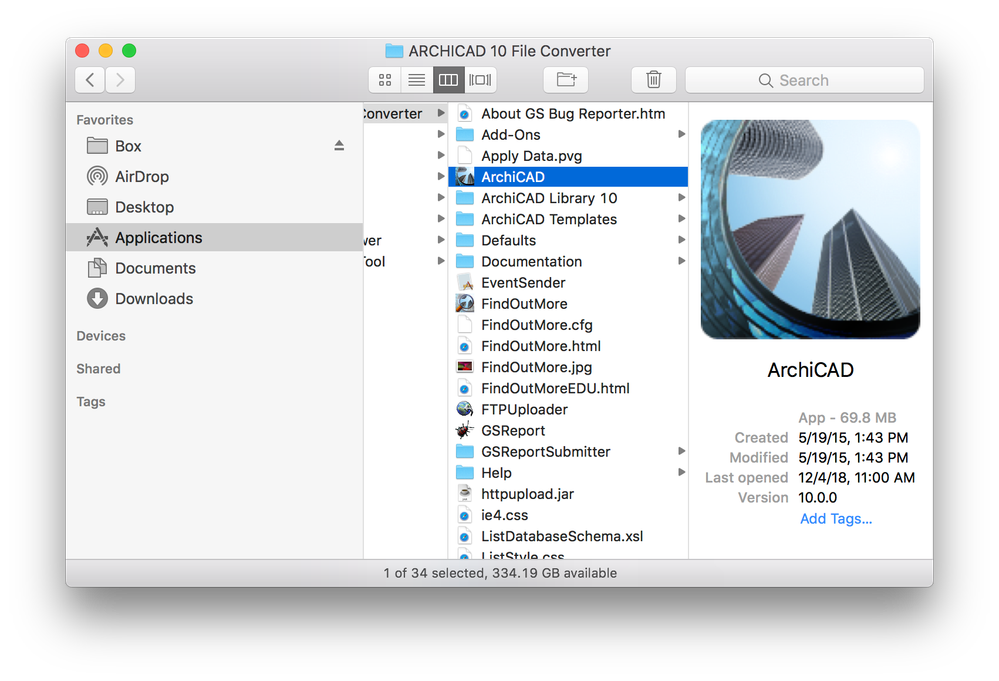

7. Right-click (or Control + Click) on the ArchiCAD app icon.
Note: You must right-click to open the app the first time only to authorize macOS to open this app.
8. Click Open on the appearing dialog.

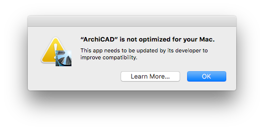

11. On newer macOS versions you might see a message saying the app is not optimized for your Mac. Click OK. This message appears for many older apps and is not significant.
