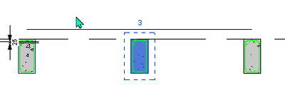

Is there an array that can be changed in archicad?
LeeJaeYoung

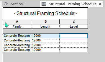

Spacing and number are possible.
You can also check the number in the schedule.
AC27 on window 11

An array for what exactly?
Do you want to show/adjust the spacing in the schedule?
That is not possible, unless all of those beams are actually one object with a parameter that controls the spacing.
If they are separate beams, then there is nothing you can do to schedule the spacing.
Lingwisyer
Guru
If you know your total length, you could use the Edit => Distribute function. Then if you group the objects, you could then move the end ones to modify to total length and redistribute.
