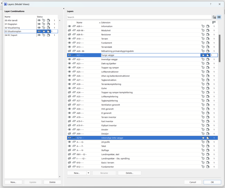

it seems the sorting of Layer Names in AC 26 is a little different than in previous versions (besides handling attributes in folders etc.)
The way AC sorts layers, seems to have changed.
Previously you could use multiple digits, to create "subcategories" after a Main layer e.g A21---- and then sublayer A214--- Etc.
Since AC 26 Layers are sorted as "real numbers" (I guess) meaning 3-digigt numbers will  always be higher than 2-digit numbers thus A214--- will be placed below at the bottom of the list, instead of "just" under A21---- Please see attaced picture for reference:
(This almost a National standard regarding Layers and their names)
Is this an intended change/feature, or an unlucky consequence of the new Attribute System?
Below is a simple screenshot showing the differences from AC 25 to AC 26
Kind regards
Thomas

This has been intentionally fixed in Archicad 26. Both folders and attributes (including layers) use natural sorting now.
