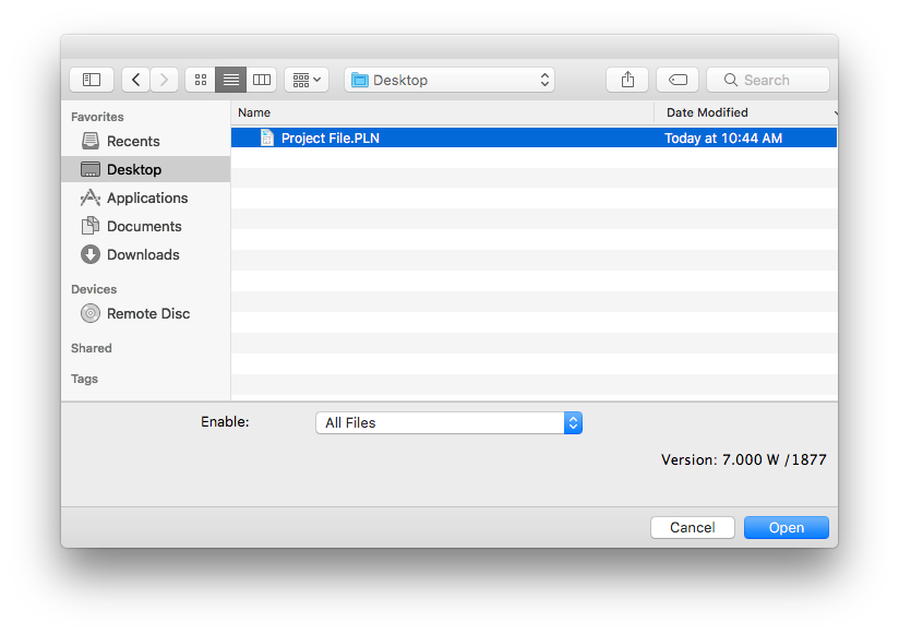

5. Select the ARCHICAD 6.5, 7 or 8 file and click Open.

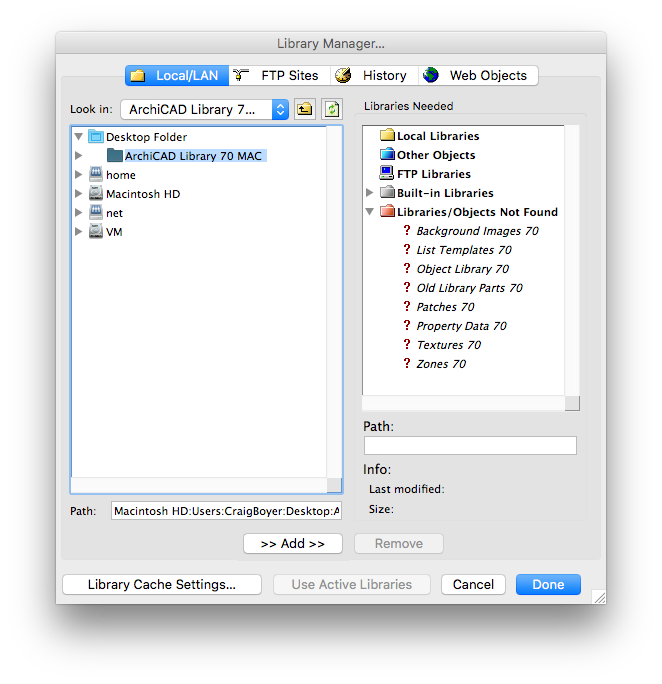

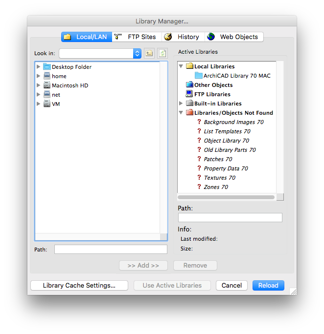

6. In the left column of Library Manager, locate the missing libraries on your computer, select them, click the Add button and click Done.
Note: Older libraries including those for versions 6.5,  7 and 8 can be found here for the USA users and here for international users.

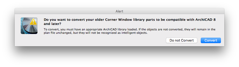

7. When opening version 6.5 or 7 files the following alert may appear. Click Convert. The Library Manager will then reappear and you'll need to click Reload.

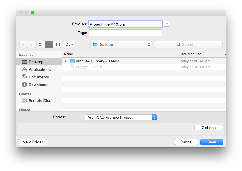

8. Go to File > Save As... and choose ARCHICAD Archive Project (.PLA) for the format. Name the file in a way that denotes it is an ARCHICAD 10 file.
