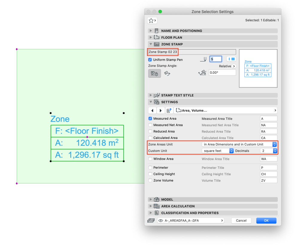

One of the default Zone Stamps (02) can do this easily by adding Custom Units to the Measured Area.

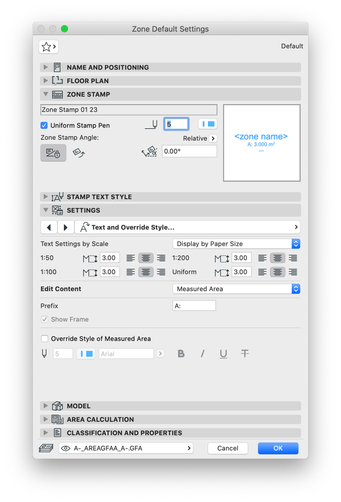

The Zone Stamp 01 however can’t do this right away, because only the prefix can be changed (under Text and Override Style… choose Measured Area at the Edit Content dropdown), but there is a solution!

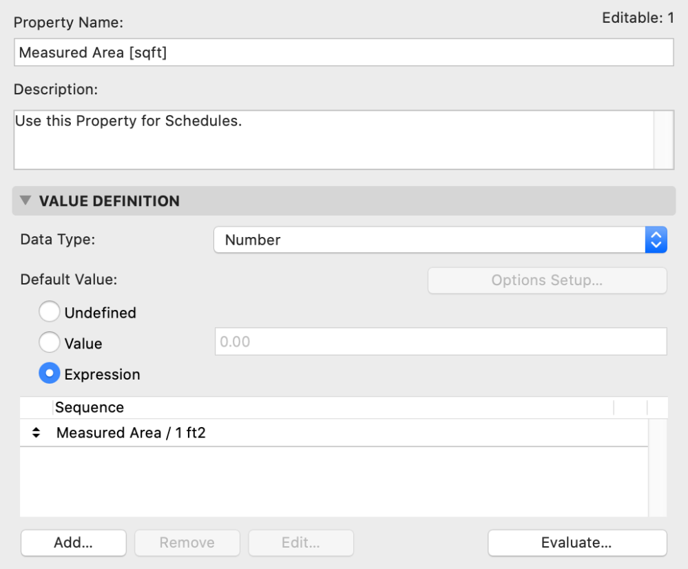

The new property is a Number (otherwise as Area it would follow the global settings). The value can be created with an Expression which converts any of the desired area types to square feet by dividing with 1 ft2.
As a number, this property can be summed up, therefore can be used in Schedules.

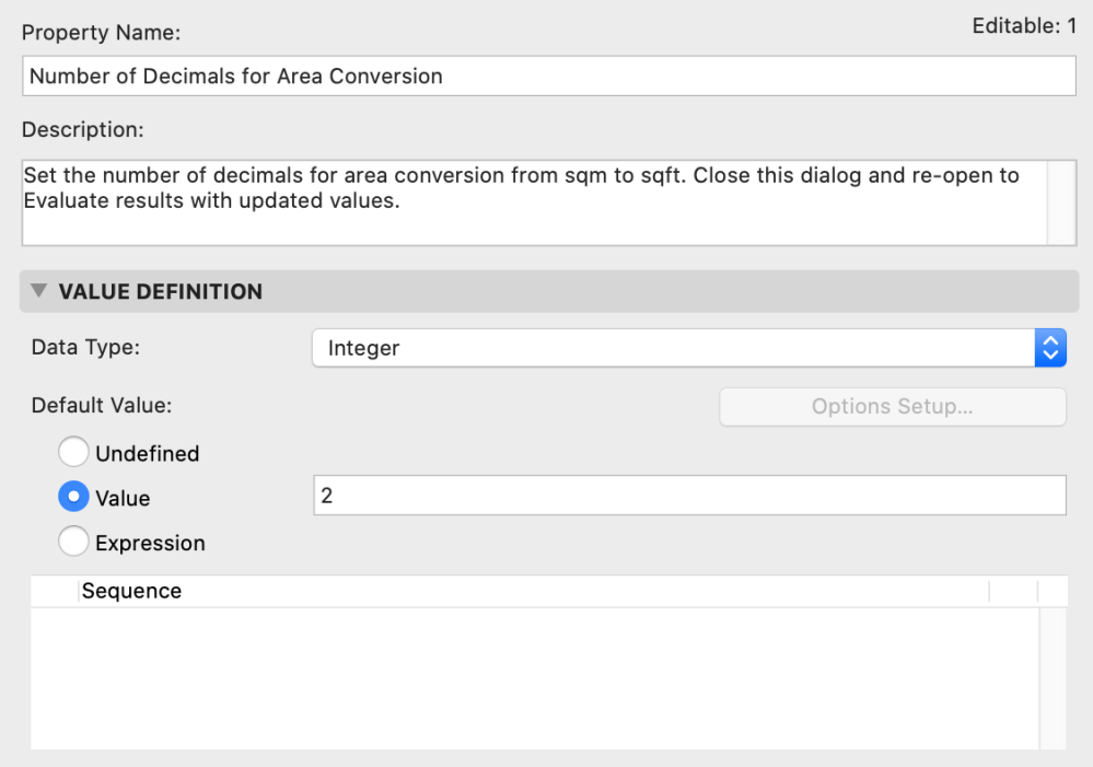

In the Zone Stamp this would only show the number and not the unit, so it is recommended to create other properties as well:
The first is just to control the number of decimals (Integer), set with a default value.

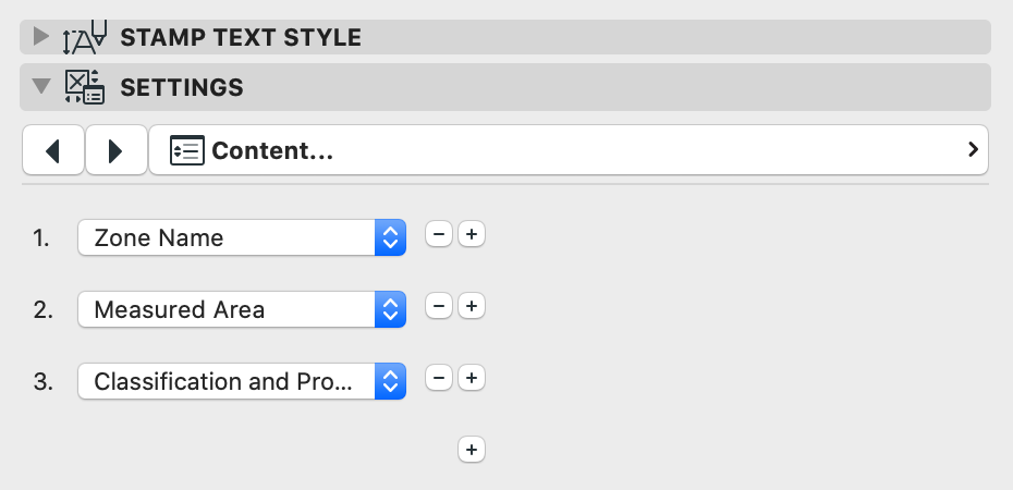

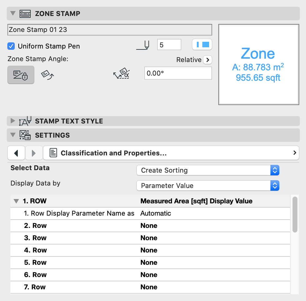

Choose this property to be shown in the Zone Stamps settings, go to the Settings panel and add Classifications and Properties under Content….
Browse for the Classifications and Properties… group and add the newly created property to the first row.
That’s it!
