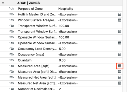

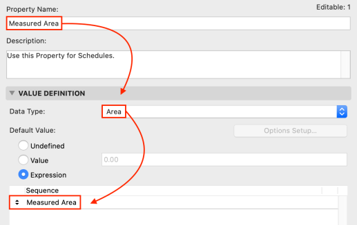

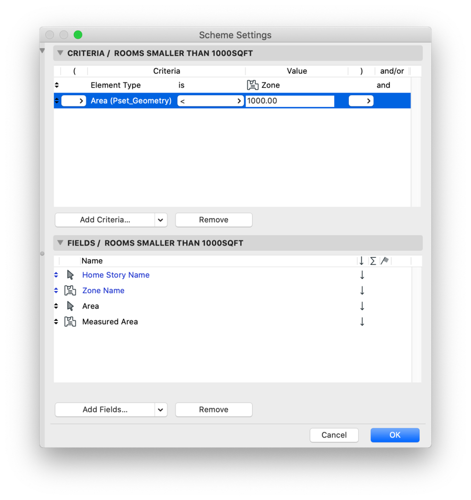

In case of the Area, the General/Area or Zone/various Area parameters are only available as Fields, but not as Criteria. But Area is available as a Property (as well)!

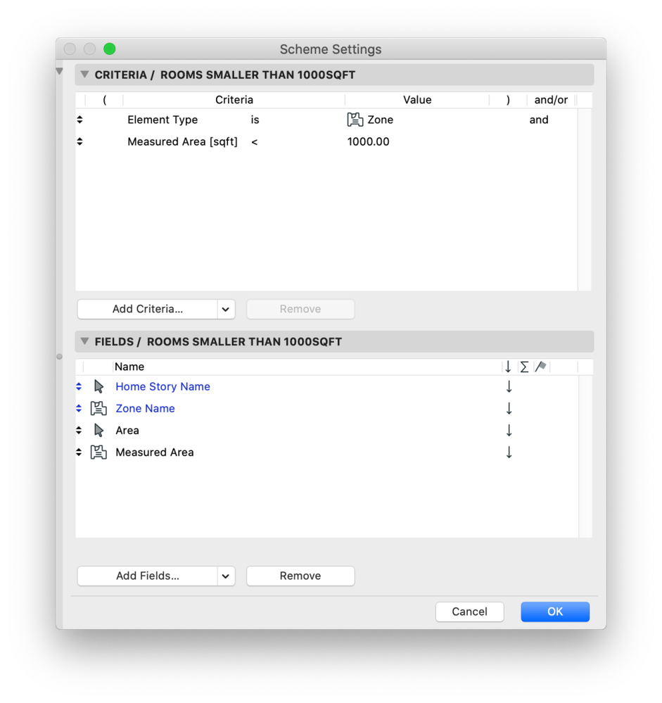

Once it is added you can set the value and the relations:
If you only need the Criteria and not the area conversion then of course there is no need to convert to sqft but leave it as is as an area type (or add the /1m2 in the Expression and leave it as number as in the previous post):

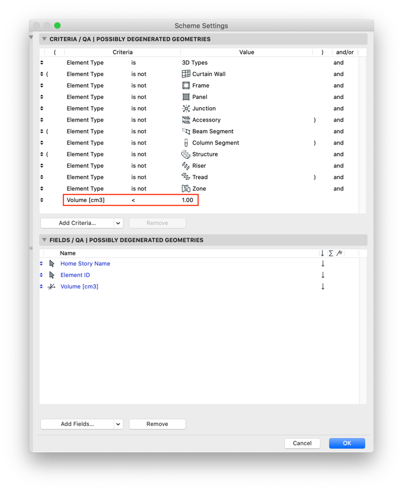

In the submission template of Singapore we use a similarly constructed Property and Schedule for audit purposes to filter potentially degenerate 3D elements by listing those that have an unrealistically small volume for example.

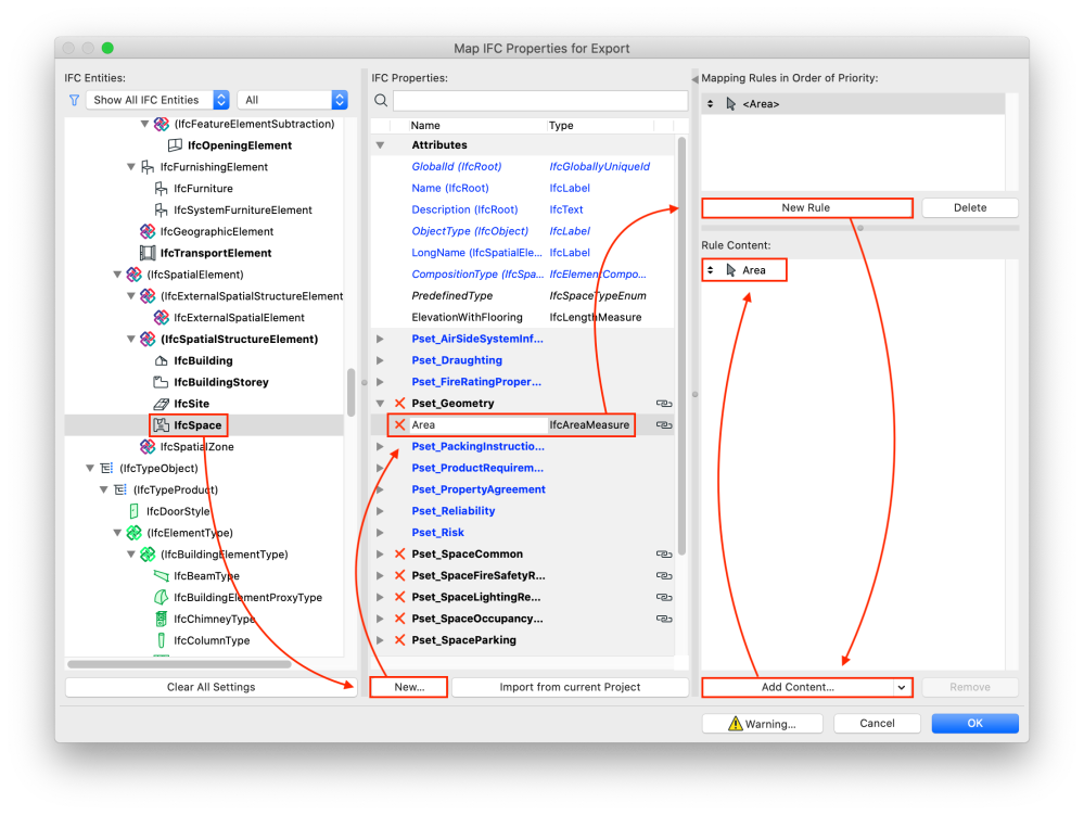

If the Area is used in IFC mapping then it can be added as Criteria as well with relations, but the main purpose of IFC mapping (File/Interoperability/IFC/IFC Translators…/Property Mapping presets) should still be the IFC Export and not Scheduling.

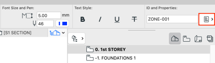

The IFC Property does not show the Area value in real-time in the element settings and cannot be converted to different units or calculated either as if it was a Property (Info Box dropdown/calculator icon), which doesn’t show up real-time either and shows <Expression>, but can be quickly displayed on the fly.
Of course this is not an issue with a single area as you can see its values in many places, but if you have more complex/concatenated properties.
