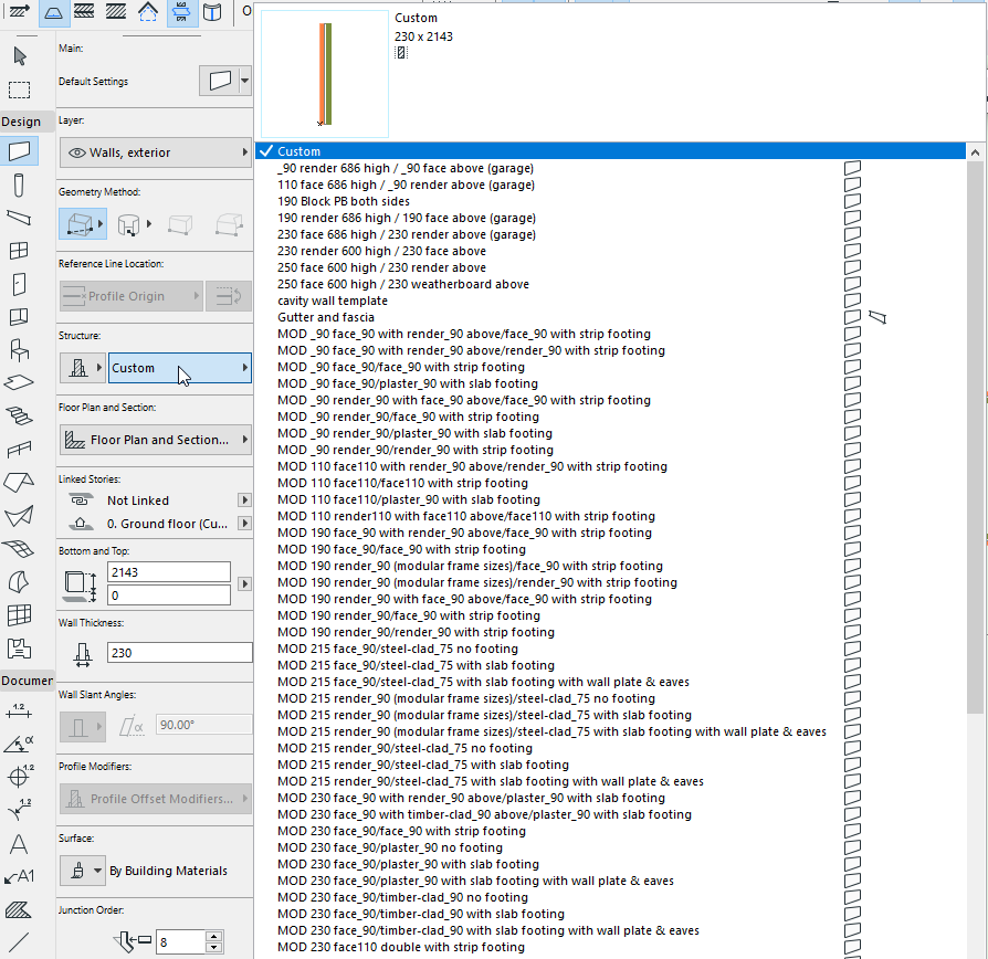

This is part of my list of complex profile walls from version 25.
The names you use are really just what makes sense to you (and whoever needs to use your files).
In my case here for example, the 'MOD' means the profile has profile modifiers.
And of course in 26 you can have folders to group similar profiles.
I would still keep unique and descriptive names though in case you view the entire list and not the folder structure.
