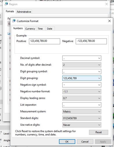

Thanks for your response, But I still don't quite understand. I've already set the digit grouping in the windows control panel, but I still can't add the dollar sign and separator in Archicad.
2024-09-13 09:08 AM
Digit grouping from your OS won't help here.

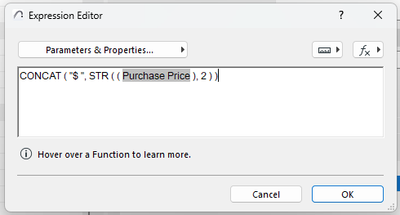

You'll have to use the Property Manager and create a new property which does what you want. This property can then be inserted into the schedule in place of the price information for the element.
As an example:
I don't know of an easy way to split the price data for inserting the commas, but maybe someone who has already done so will chime in.
2024-09-13 09:24 AM
The problem with creating a property to show $ symbol, is it will now be a string and it won't total in the schedule.
I would just live with "$" in the column/row title which you can customise to say what ever you want.
