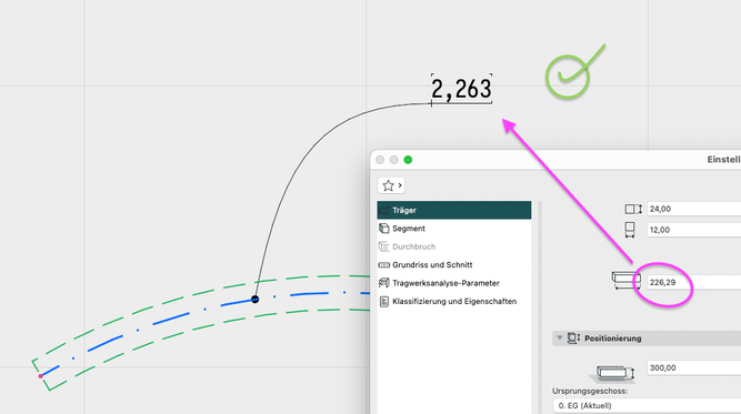

I can't confirm that. 3D length works fine for me:

Works for me in the floor plan, but not when vertically curved beam. Is both inclined and vertically curved, quarter of a circle, and is giving me some random value, cant figure out which one, is neither chord length, projected length, nothing, just some number, smaller than real length...

runxel
In that case, yes, you're right. That's a shame. For vertically curved beams there is no 3D length.... 😒
