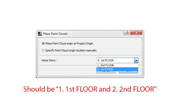

In Version 4013 USA FULL, Story "matching" is not happening properly when importing point clouds. The USA version does not use 0 (zero) Story. The first floor is "1. 1st FLOOR". I believe that this is one of the key differences between North American and European releases of Archicad.
When I click "Import Point Clouds", I select the e57 file, then "Create and Place" the point cloud, and the "Place Point Clouds" dialog comes up, with a Home Story selection box.
As per the attached image, the stories are shown with a ground floor starting at 0 and not at 1 as it should.
This seems to be a bug to me.
I also can't understand why there isn't a layer selection tool here - to place the point cloud on the intended layer.

Hi afingret,
Thank you for pointing out the issue with the stories not matching. I will report it to our development team. If anyone ever feels they have found a bug in the software please report it to your local reseller, distributor or support office so that they can put it into our internal database. Although I and others from GRAPHISOFT try to keep an eye on posts here, there is not a guarantee we will see them. The primary purpose of this forum is for users to assist other users. But still, thanks for posting here as well. Keep doing that also. We will do our best to get the info from all sources.
BTW - the Point Cloud is considered as an Object, so whatever default layer the Object tool is set to before importing, that is the layer the Point Cloud will come in on.

afingret,
What does your story settings show? If you have 1st and 2nd stories then this is indeed a bug.
I have processed it and reported it to the Developers.
Thanks NCornia, I look forward to an eventual software fix.
I understand about the object layer, however it would be more contextually appropriate to select the point cloud layer at the time of placement.

My Story Settings show:
2. Floor 2
1. Floor 1
-1. Basement
There was a time many years ago when we had an International version of Archicad, so I'm aware of the 0 story as being default in the rest of the world. It created messy teamworking and file sharing issues at the time.
When I saw the 0 story show up during point cloud import, it immediately resonated with me as a bug.
It is a bug, I'm 99% certain.

afingret,
Thanks for letting us know. As I've mentioned below, I have reported it to the Developers and it should be taken care of.
