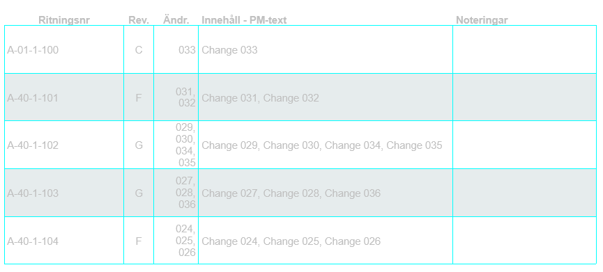

I am stumped with trying to get past this point and maybe I have missed something - so if anyone has a clear idea - please point me in the right direction.
I'm trying to set up a formatted template of our change register which is based on the document number and then a list of all the changes that goes into the current revision/transmittal.
My problem is that I can't seem to separate the changes into rows but they show up grouped with a comma as separator (see screenshot below)
In a "normal" schedule there is always the option of controlling the merge conditions - but I can't seem to find that here.
For a large project this could be difficult to read as the changeID can be neatly controlled with [Wrap text] - but the change name (description) cannot.
Any ideas?
