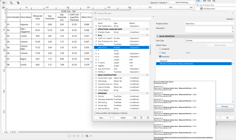

OmarA
i create a new basic expression live (area of the windows + or / measured area)...all is fine,
but in the schedule i can't see the result, also with the logical function..true and false
there is soma block o something elese?
thanks so much
om

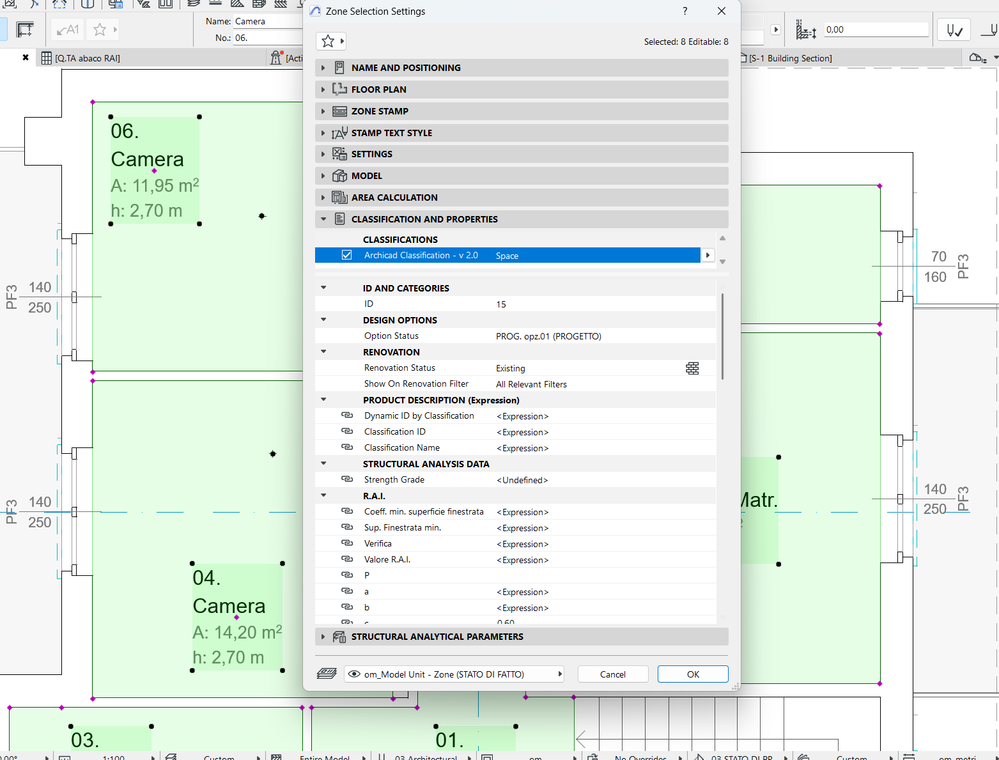

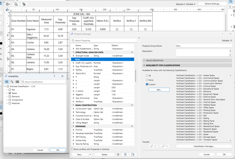

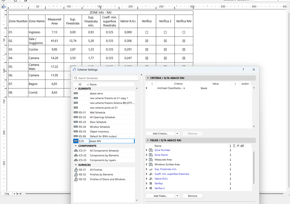

Hay Barry and Stefan, now all is perfecly showed!!!
now i have to do a memory sequence for this and study all of this...
but i hunderstand that classification in proprerty ZONE has to be the same of the Property manager..
that all, i think
thanks so much, very good help !!

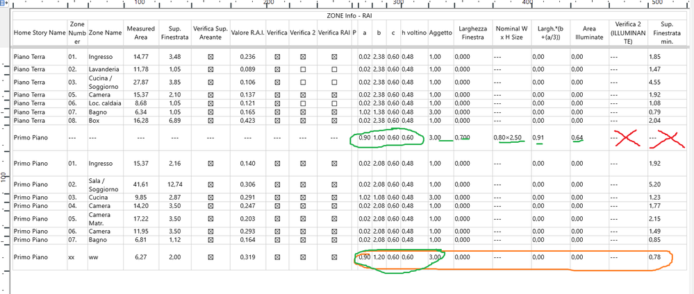

But now i can't joint some data windws in the same schedule, it creates a new line..😤copying  window...
thanks, hope it's the last help
omar
