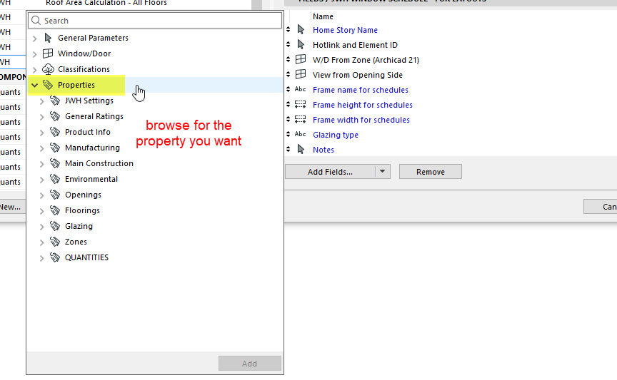

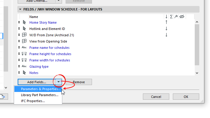

In the schedule fields, you need to click the arrow to 'add parameters & properties' (or you can just click the 'add fields' button it seems).
Then browse for the property you want to add.

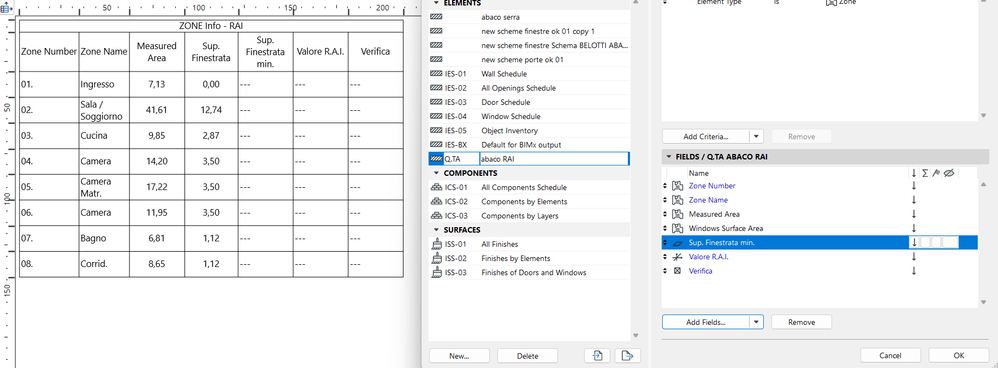

OmarA
Kelly, thaks for the answer but the problem is another,
i know how add new fields but the result of the expression put in the schedule is...nothing
i can't undertand, every seems ok..
check the print screen
thank and have a nice day

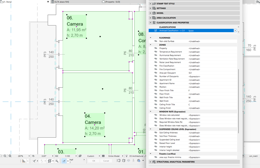

OK, so in Property Manager, you are happy that the expression evaluates correctly.
If so it then needs to be set so it is available for a certain classification.
That classification then needs to be set for your zones.
The zones will then have those properties.
If you select a zone and look at its settings, you should see those properties, if the zone has the correct classification and that classification is associated (made available to) those properties.
Do you see the correct property values in the zone settings?

So when you select a zone in plan, and look at the properties in the zone settings, do they have the correct values?
Can you show a screen shot of those zone properties?

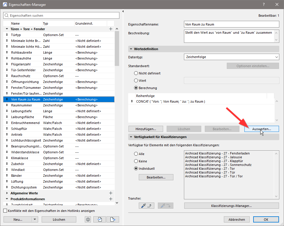

Stefan L_
Rockstar
Would you mind sharing a screenshot of the relevant property manager window?
Stefan - AC ...-29GER, WIN11
OmarA
thanks Barry and Stefan, this is the sreenshot with some proprieties..
which proprieties i have to  have o put in??
i'm e bit beginner in BIM info and model construction
thanks
Stefan L_
Rockstar
No, I meant the Property Manager with your newly defined expression.
If you select one oder several zones in your floor plan and then open the property manager, you can click the marked button and check if you get reasonable results. If not, your schedule won't work either.

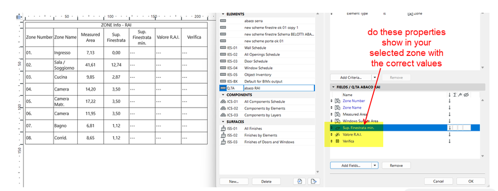

Thanks, but select just one of the zones.
Do you see those properties you are trying to schedule and do they have a value/
