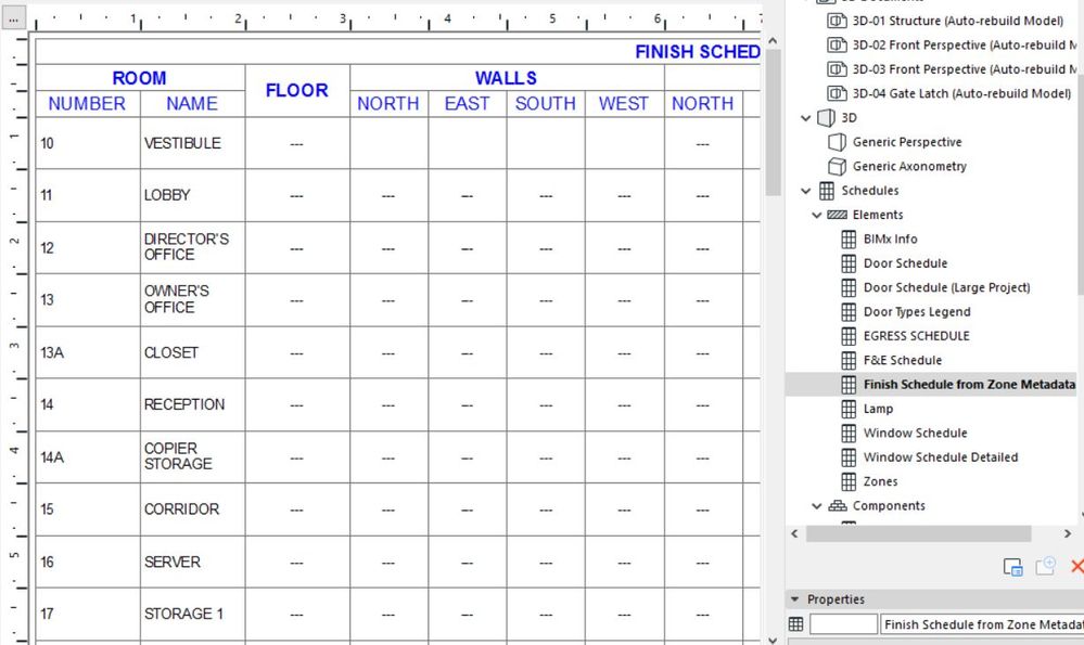

I cannot seem to get my room finish schedule to populate with information input into each zone. I am using Zone Stamp 02 21, and where in the stamp do I put information for it to show in the schedule. The finishes are not coming from the model, just from the input. Thanks.

Could you perhaps post the Scheme Settings for that schedule?
I think that might help others to propose a solution

I have checked with Graphisoft for an answer, and it turned out that the default Room Finish Schedule in the project map is linked to Zone Stamp 01 21, and I am using Zone Stamp 02 21. I was told that 02 21 is more flexible than 01 21, but the problem is that 02 21 does not seem to have the North, South, East, and West Walls configuration that I need. So anyway, being in the middle of a project, I filled in the missing information using good old Excel.
