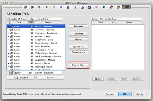

3. Open Attribute Manager. On the right side, click "Open…" to load your template file from Step 1.
4. Select the attributes you wish to use as the "replacement" attributes, and “Append” them to the left side of the Attribute Manager - make sure you do this for all attributes that will serve as replacements.
5. From the "All" tab of Attribute Manager, use the "Print to File…" command. This will generate a tabbed delimited text file that contains all the attributes listed at left.
Info_18x18.png NOTE: It is recommended to use “Print to File” from the "All" tab of Attribute Manager: This way, you can include all the project’s attributes in the generated text file. (If you “Print to File” from another tab, you will export only the attributes belonging to the selected tab – of course, this may be sufficient for your purposes.) 6. Open the generated text file in a spreadsheet application.

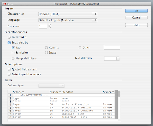

In Open Office application:
In this case, use the open command and choose the "Text CSV" file format to open the text file.

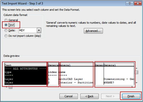

If you use Microsoft Excel, use the appearing conversion wizard (Note: Using drag and drop with the text file will not run this wizard, it is only available via the “Open” command):

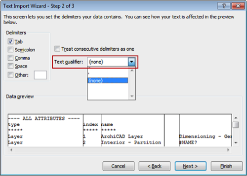

  • In Step 1, choose “Delimited”.
  • In Step 2, for the Text qualifier option, choose “none”.
  • In Step 3, select each column in turn and set its data format to “Text”.
  • Click Finish to open the text file.

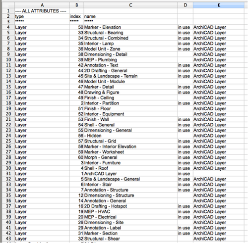

7. In the “name” column, find the attributes you will use as replacements for the existing ones. Copy these name(s) and paste them into the last available column (after the "in use" column; column E in the image below), in the row of the attribute to be replaced. Thus, ARCHICAD will delete the attribute that is shown in the "name" column, and replace it will the attribute that you have pasted into the last column.
8. Do this for all applicable rows (i.e. all attributes to be replaced).
