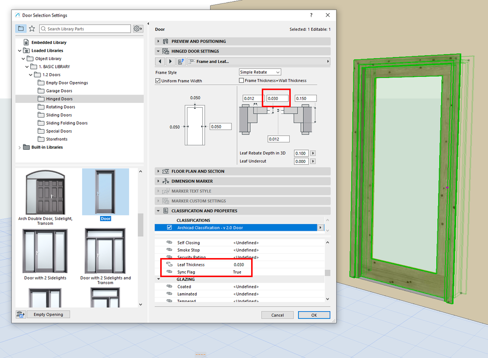

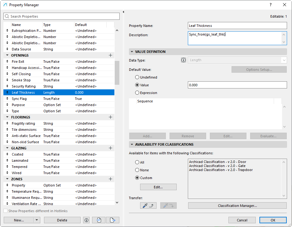

1. Create Property to sync to. type the syncing code into the Description field. Make sure the Property has the same Data Type as the parameter (Length). Also, make it available for Door Classifications):

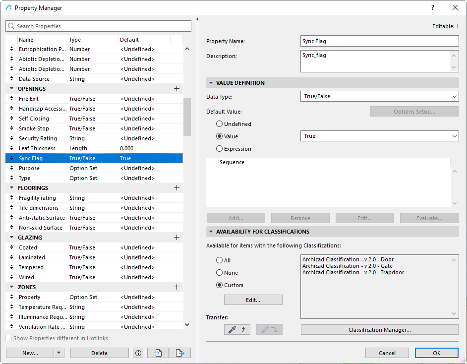

2. Create the Sync Flag Property (the Property will sync only when it is set to True):

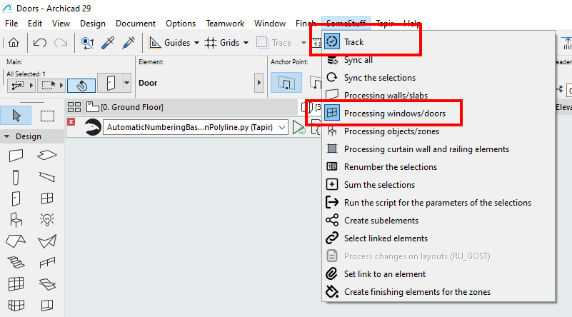

3. Enable syncing from Doors/Windows, and enable Tracking:
4. Run the Sync All or Sync the selection command of the SomeStuff menu, and the Property will get the value of the Leaf Thickness library part parameter of the Door (in this example):
