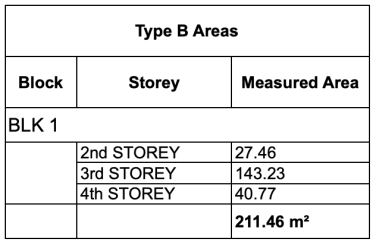

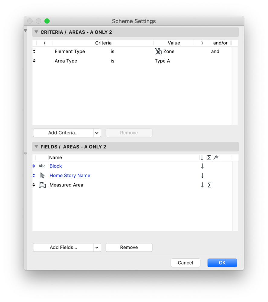

There are no issues if we use the value of the Option Set as a scheduling criteria and list the Measured Area – as long as we reach a story that has none of these.
These would be the results for the two types respectively:
The bigger problem is that any other lists are also likely to be missing some items and we will not be able to even crop these tables and manually put them next to each other as Drawings on the Layouts (to show the area types side-by-side) as the stories are not aligned.

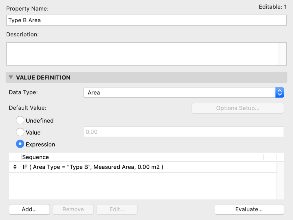

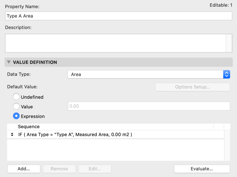

Here comes the trick: we can set new properties instead of using the generic area properties: Type A Area and Type B Area. These properties should directly show the Measured Area if the area type is set as Type A and be zero for setting the area type as Type B (and work similarly in the other way around). Let’s use the IF function!
This is the base property for choosing the area type with its options:
And here are the two area-related properties. Note that the data type is Area, this way it will show as m2 or whichever unit is set for areas globally. If the Area Type property was set as Type A, it will show the Measured Area as usual and will show 0.00 if the previous one is set as Type B. 0.00 needs a unit – because the data type is Area, not a Number or Integer, – therefore m2 is just typed in the end (it cannot follow the global settings, so make sure they match).
Set the other property similarly as well:

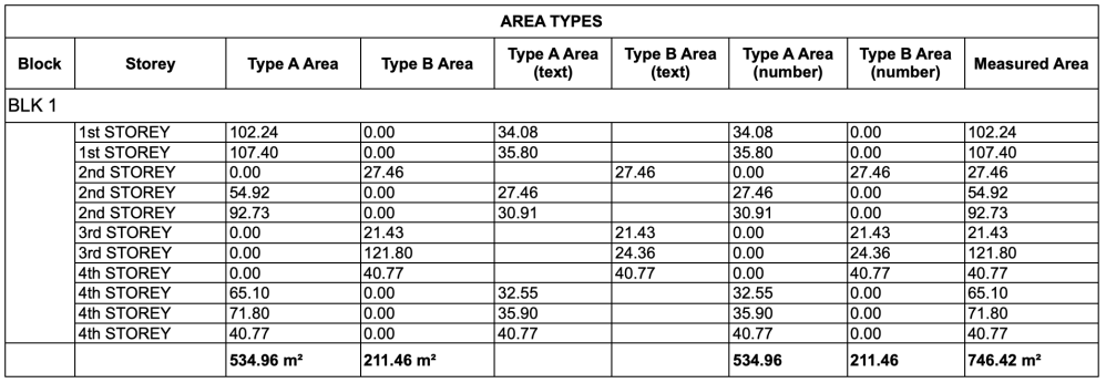

These two and the Measured Area (only for reference) are added to the final Schedule:
The result:
Note that the Merge Uniform Items and the Show Headline options are both checked.

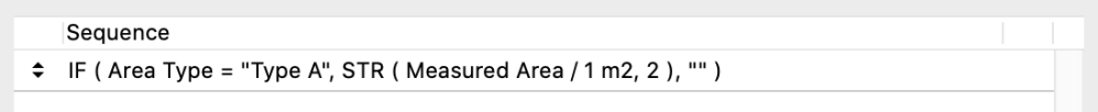

Alternatively you can try converting the properties to texts (String) in the end as that can be empty, but in that case you will not be able to summarize the values nor merge them properly. See those examples below:
  • The property/expression set for String data type – this has control over the area units by dividing by 1m2 and “” results in the empty cell. The area needs to be converted to string as different data types cannot be used for the true/false results:

Here is a combined Schedule with all the different data types for reference (area types, string types, number types):
The Merge Uniform Items and the Show Headline checkboxes are still checked above, which reveals the issue with the non-Area data types: besides Strings, Numbers would not merge correctly either (this makes sense if you think of the regular information using number formats, like sound transmission, while sometimes it would be good to be summable) even though they have an overall correct grand total.
