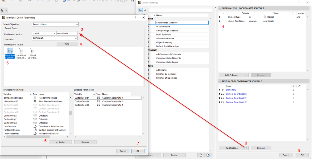

Yes, you can Schedule the coordinates of these objects by scheduling the parameters of the Library Part:
1. Select Criteria: "Element Type" equals "Object", AND "Library Part Name" contains "coordinate".
2. Click the down-pointing Arrow button to the right of the "Add Fields" button and select "Library Part Parameters".
3. In the uppermost field, select "Search Criteria", use the "contains" option, and type "coordinate", to find those Library Parts in the Libraries the name of which contains "coordinate".
4. Click the "Find" button.
5. Click the first Library part found in the list to select it. Its parameters will be listed in the lower left.
6. Find and select the "Custom Coordinate X", "Custom Coordinate Y", and "Custom Coordinate Z" parameters in the list and click the "Add" button to add them to the Schedules Fields.
7. Click the "OK" button.
8. Click the "OK" button again.
Now generate the Schedule and the values will be scheduled. You can modify the Header Text of the Columns.

Solution

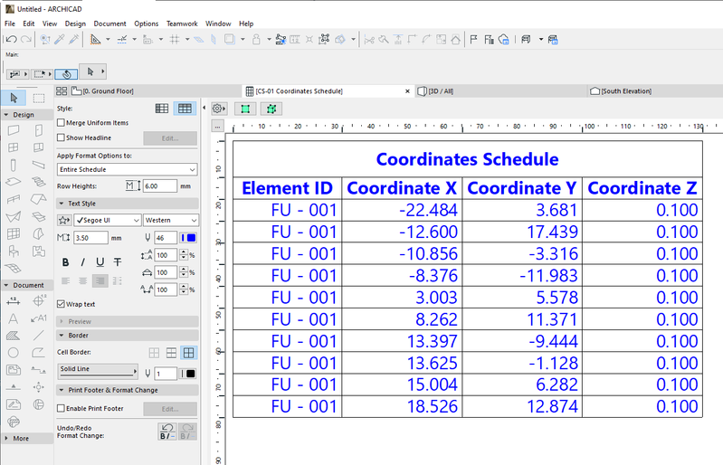

OK, i finally found the time to try this! for some reason i never tried coordinate 22, only 19. Thank you very much, you just saved us a lot of time.
Nice to know we can still schedule coordinates. I remember we had a problem for a while, (last two three versions).
yes finally!
