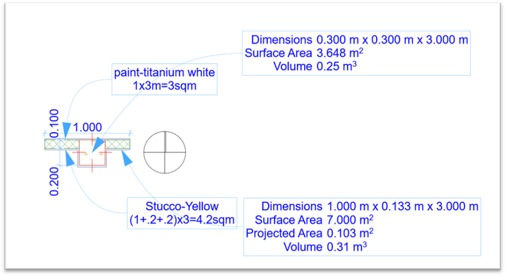

Hi everyone,

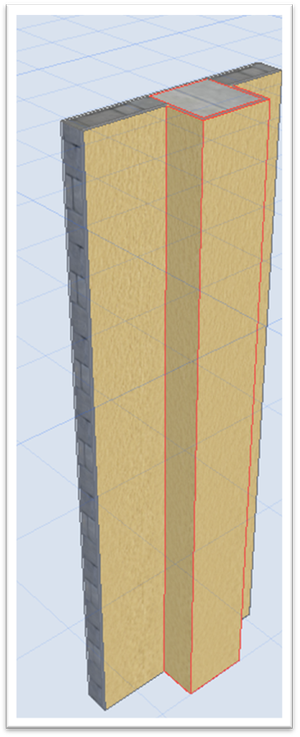

I am trying to extract accurate paint/finish quantities for a real-world structural condition where a structural Column intersects wall and is wrapped automatically by a composite Wall skin. (Refer plan & 3D)
The Model Configuration:
wall is 1m long X 3m tall (Concrete block (intersection priority 750) +gyp plaster (IP-220) - finish (Titanium-white) +Cement sand plaster (IP-640)- finish (stucco yellow)
Column is 0.3x0.3x3m tall (wrapped)(Reinf conc core (IP-800)(no veneer)
Surface Schedule (Exposed Area parameter):
No matter which scheduling method I use, Archicad refuses to calculate the true unfolded surface area of the wrapped protrusion(Stucco-yellow) (which geometrically should be 4.20 m²). Instead, it falls back to a flat bounding calculation(1.98sqm(?))
The Problem with Scheduling:
What I Have Already Tried (None of this works or are viable):
My Question:
Why does Archicad's calculation engine completely fail to unfold the perimeter length of an automatically wrapped composite skin? Is there a known workaround to force either a Surface or Component schedule to measure the true unfolded perimeter of a wrapped element face without resorting to manual calculation multipliers?
