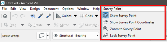

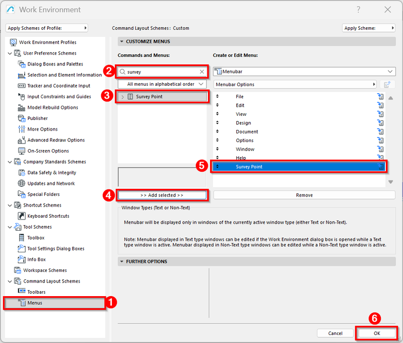

Hi @Todd Thomas
You're right, it doesn't work well in the toolset, but you can try it in a custom menu. 😉
More information about Survey point HERE.

Todd Thomas
Hi Ricardo,
Yes. It seems like the survey point is always placed in your project you just need to turn it on. Options / project preferences / survey point.
Thanks
