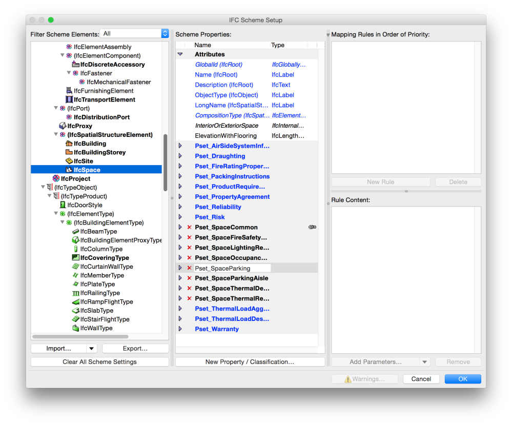

1., Open File/File Special/IFC 2X3/IFC Scheme Setup… and select IfcSpace on the left to display the available properties of the Zones.

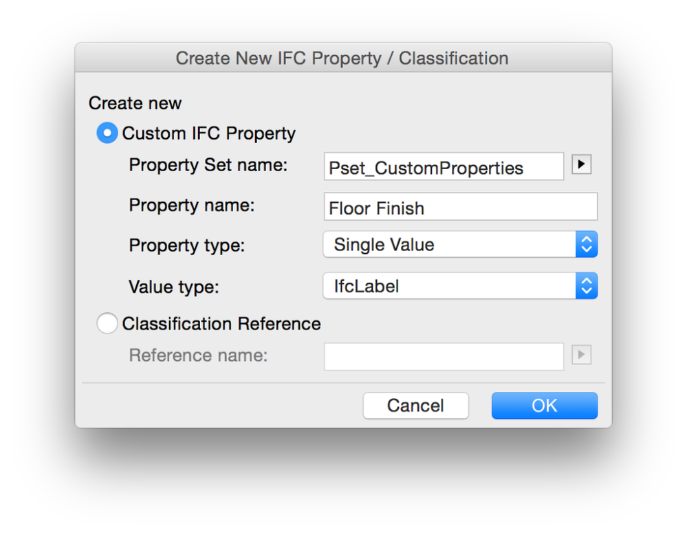

2., Click New Property / Classification… in the middle and create a new property for the floor finishes.
Note: It is NOT possible to map element parameters to element parameters, object properties to object properties directly or to map an IFC property to another IFC property. Element parameters and object properties however can be mapped into IFC properties.
Set the property as follows or in a manner that fits your template/standards/naming conventions.
Once it is done, it will appear in the property list with a red X, indicating that it is a custom property (not included in the initial scheme). Let’s map the Cover Fill parameter to the new Floor Finish IFC property.

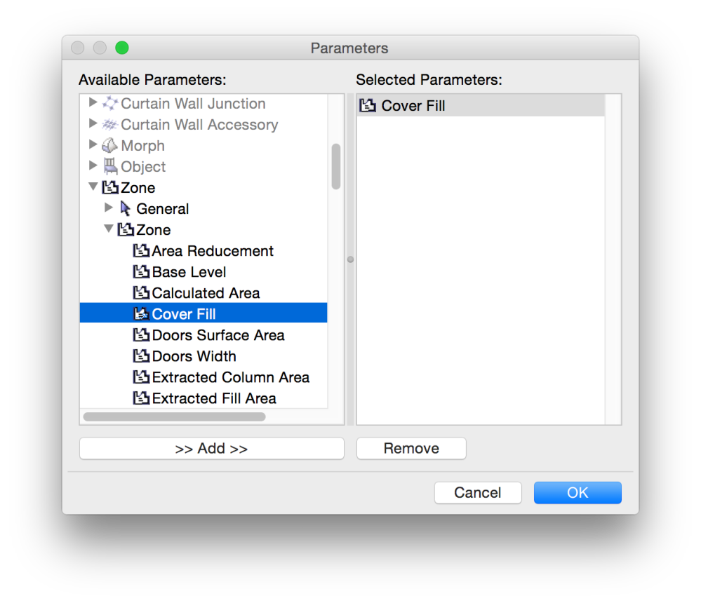

3., Click New Rule with the Floor Finish property selected and the Add Parameters… button to choose Zone/Zone/Cover Fill. Click ›› Add ›› , close the dialogs and return to the Zone Settings.
screen-shot-2016-03-09-at-16-09-05.pngThe Tags and Categories will show the mapped content already.

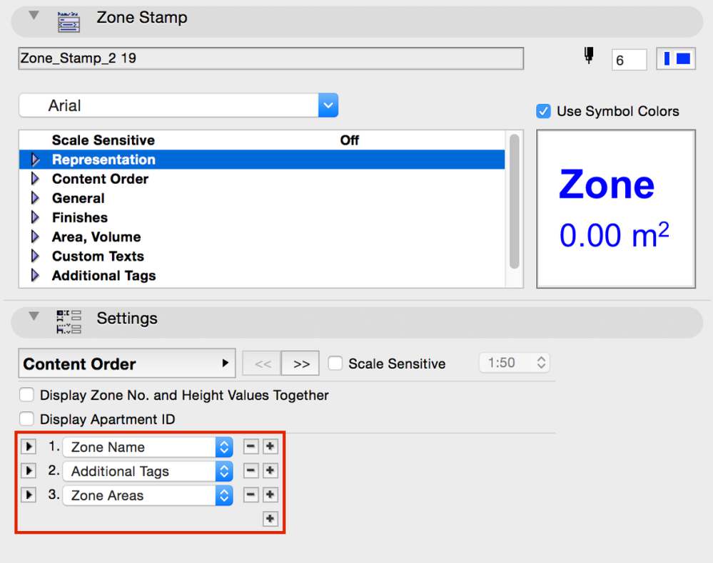

screen-shot-2016-03-09-at-16-11-291.png4., Go to the Settings panel and use the (-) buttons to remove the unnecessary entries, make sure that instead of Finishes, the Additional Tags are shown.

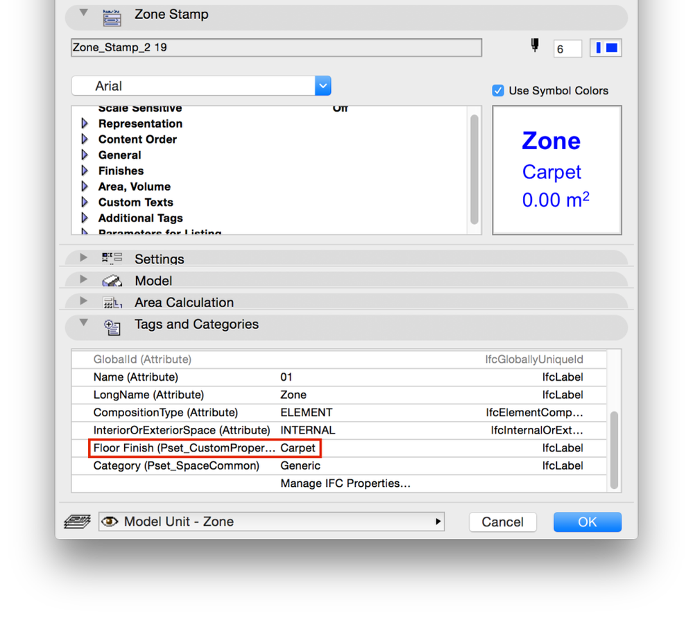

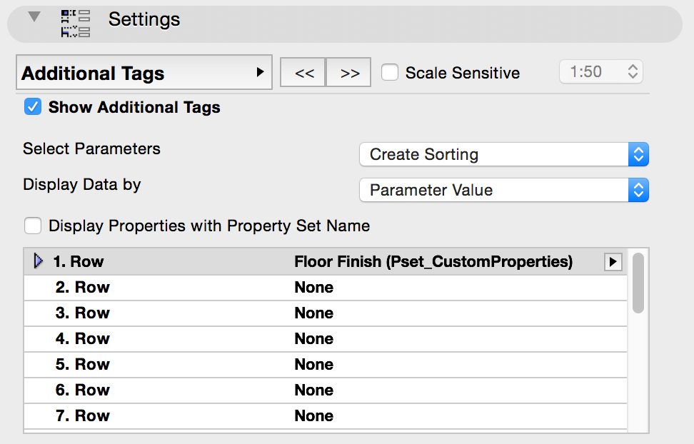

5., Switch to the Additional Tags page and check Show Additional Tags, choose Create Sorting (so that only those IFC properties will be displayed that you choose specifically), select Parameter Value and set the 1. Row to display the newly created Floor Finish parameter.
The zone will show the mapped Cover Fill name as the Floor Finish property. Now you just need to specify a naming convention for the fills, so that their names actually represent floor finishes.
