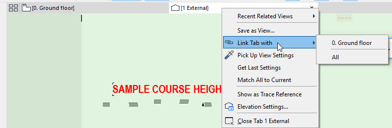

ArchicadGuruWannabee
Hi Guys,
I think I am commenting on the same topic as above.
So when I select certain layers to be visible on say a Worksheet or Storey, when I navigate via the project map on the right to say another Worksheet or Storey I retain the same layer visibility.
This is good.
The problem is when I navigate between 2 Worksheets or Storeys using the tabs at the top, the layer settings don't update.
How do I fix this? This is killing me.
On a similar note, is it possible to have trace references use a different set of layer visibility options to the working space layer settings?
Thanks
You can right click on a tab and 'link' them so they all keep the same layers.
Sure.
Just choose a trace reference from the View Map.
