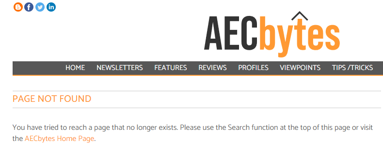

Hi Link, I'd appreciate if you could re-post those 4 articles on Pre-linked database for Archicad. It's an always current topic and the link does not work any longer.
 http://www.aecbytes.com/tipsandtricks/2015/issue73-Archicad.html
