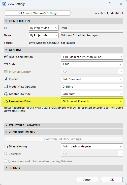

Having a problem with my window schedule. Cannot get anything to show up. Changed the walls from new to existing and nothing shows up.

No sure how to do that
Ricardo Lopez
Go to View Map, select the window schedule, right-click, and select View Settings.

the window schedule technically has a renovation status, even if it's not available in the view settings.
try setting your floor plan to a renovation status that shows all, then right click the view of the schedule and "redefine with current view settings".
schedules will not hide windows by layer, but they will hide them by renovation or design options.
That should be showing all windows.
You should have a view saved for the window schedule.
In the view settings, make sure the renovation filter is set to show all elements (unless you are wanting a specific renovation status).
