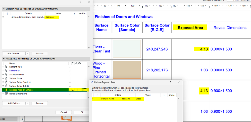

May be glass area could be obtained in a Surface schedule using Exposed Area with Glass as a Surface name criteria value.

Ricardo Lopez
HI,

Michala
I have found it, thank you very much!
amitchristian
The exposed glass area in a door or window is calculated as four times the actual value. In Archicad, glass classified under “exposed area” has four exposed surfaces.
The library part parameter gs_list_glassarea provides the accurate glass area.
